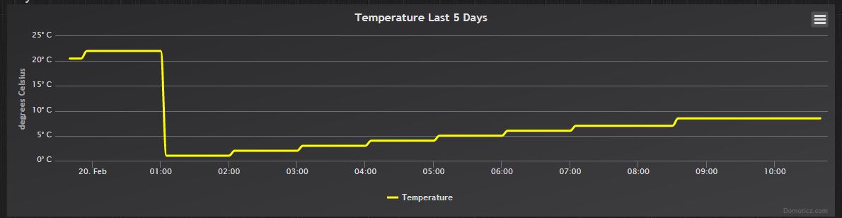

Tested with stable version 3.8153 on Win7:
the timer function of the Setpoint dummy works correct

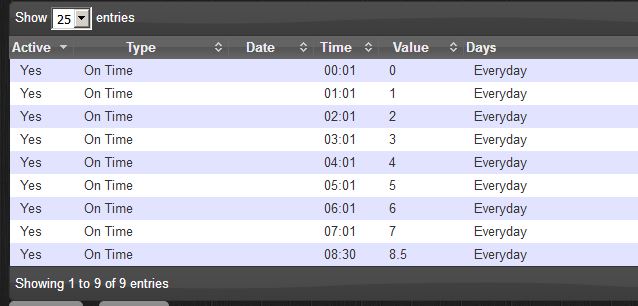

timer rules
