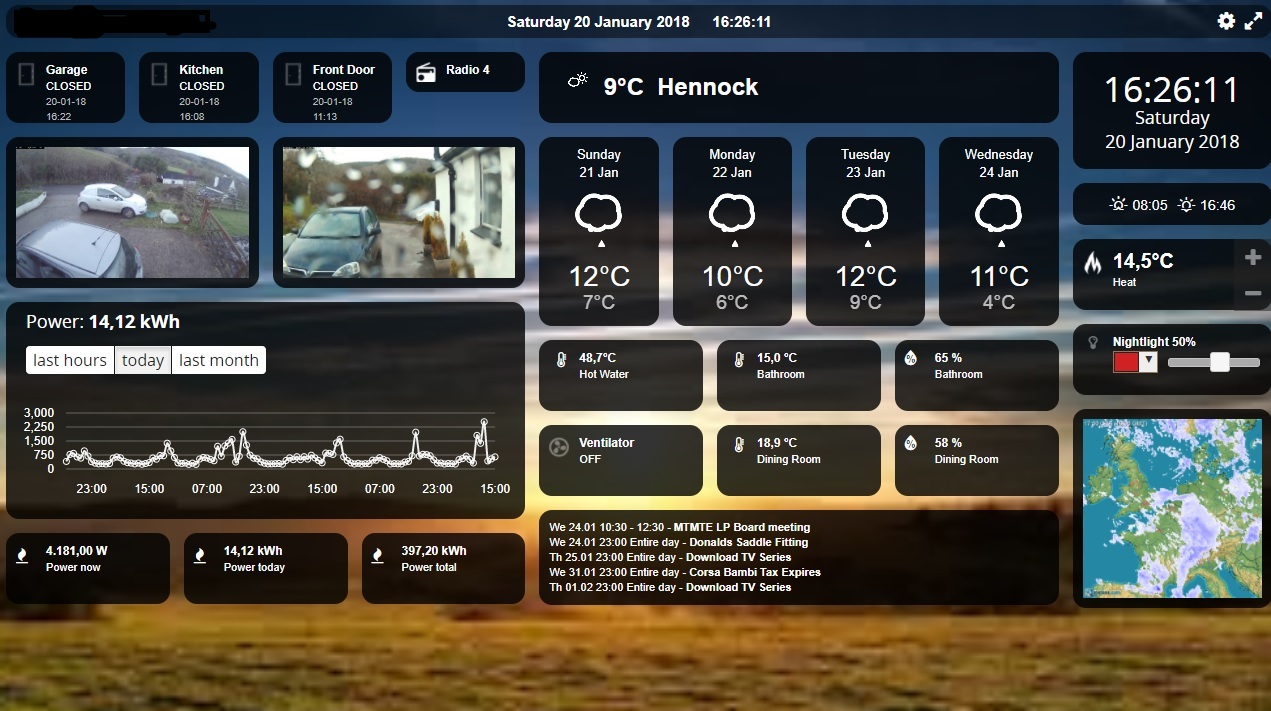

Very pleased with the results of an evening playing with Dashticz - a very nice framework. I did have some problems using the GUI interface, but not once modifying the config files with a text editor. Thanks for making it - very nice!
CONFIG.js
(2.87 KiB) Downloaded 1111 times

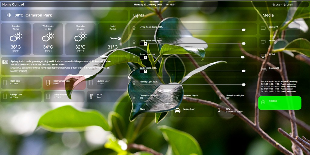

Here's my pretty simple setup, it's running on a lenovo 10inch tablet on my wall. This is a pic from chrome.

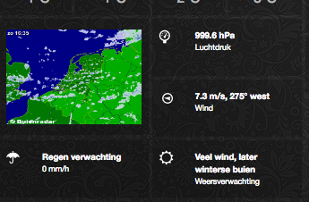

My dasboard is under contruction and I have a problem
How can I change the height of Buienradar
Schermafbeelding 2018-02-08 om 19.25.03.png (137.32 KiB) Viewed 4845 times
As you can see Buienradar has an other height, so the the blocks do not align properly
Gerard

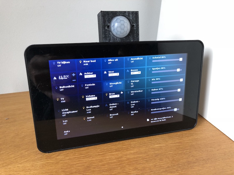

A Raspberry Pi 7-Inch Touch Screen with a HC-SR501 PIR motion sensor on top in a 3d printed case. Tricky part was the script to wake the system from sleep.
# HC-SR501 motion sensor
# https://raspberrytips.nl/hc-sr501-bewegingssensor-pir-raspberry-pi/
import RPi.GPIO as GPIO
import time
import requests
import os, subprocess, time
subprocess.call("DISPLAY=:0 xscreensaver-command -activate", shell=True)
displayison = False
maxidle = 1*60 # seconds
lastsignaled = 0
GPIO.setwarnings(False)
GPIO.setmode(GPIO.BOARD)
PIN = 8
GPIO.setup(PIN, GPIO.IN)
time.sleep(20)
print "Start sensor..."
time.sleep(2)
print "Sensor activated..."
while True:
    now = time.time()
    if GPIO.input(PIN):
        print "Movement detected! " + (time.strftime("%H:%M:%S"))
        if not displayison:
            subprocess.call("DISPLAY=:0 xscreensaver-command -deactivate", shell=True)
            displayison = True
            r = requests.get("http://viola.local/json.htm?type=command&param=switchlight&idx=599&switchcmd=On")
        lastsignaled = now
        time.sleep(7) # wait 4 seconds for PIR to reset.
    else:
        if now-lastsignaled > maxidle:
            if displayison:
                displayison = False
    time.sleep(1)

gjaa wrote: Thursday 08 February 2018 19:31 My dasboard is under contruction and I have a problem
Gerard
Fixed it my self, changed the buienradar settings (the height by RadarMapNL?w=256&h=180')
buttons.buienradar = {width:6, isimage:true, refreshimage:60000, image: 'http://api.buienradar.nl/image/1.0/Rada ... =256&h=180', url:'http://www.buienalarm.nl/widget/graphic ... lor=4395c7'}
Schermafbeelding 2018-02-11 om 17.12.22.png (110.81 KiB) Viewed 4689 times
The blocks do align now properly :| :D
Gerard
