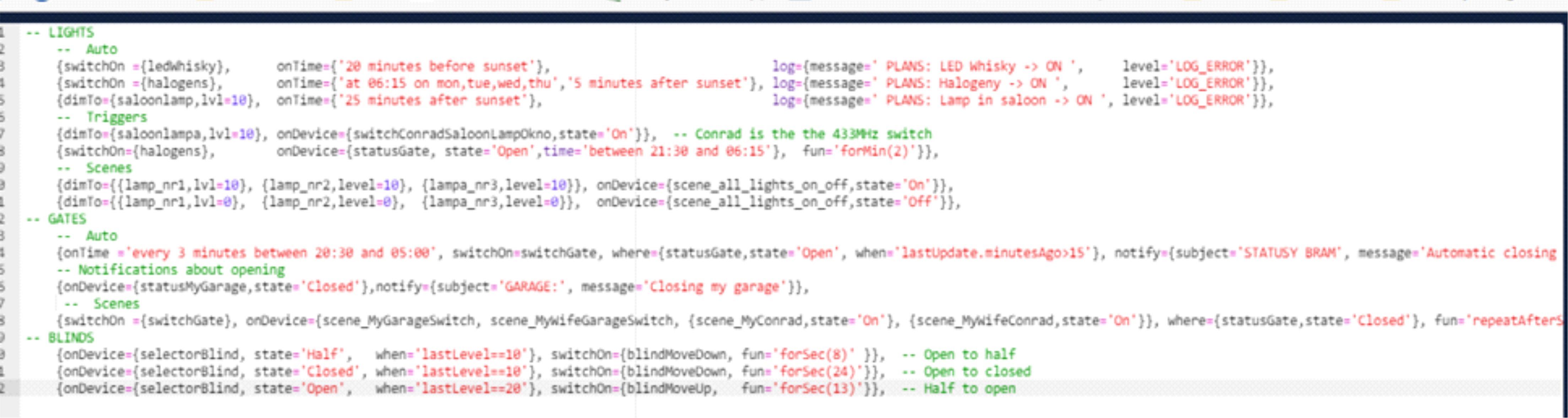

Other examples below (not too complicated): on trigger by device with 1 rule in "one line"
and other trigger by timer and have 3 rules in one plan.
-- 3 rules
-- 1: rule for when, where, notify, email
-- 2: simple rule   with where
-- 3: simple rule for dimTo
local plans={
    {switchOff={'Garage Door 1', 'Garage Door 2', when='lastUpdate.minutesAgo >15' }, where={{'temperature-out', when='temperature < 25'}, {'ImNotHome', state='On'}},
      log={message='Lamp1 flash  '}, notify={subject='RULE 1',message='Auto close garage door'} , email= false },
     {switchOn={'Lamp outside 1','Lamp outside 2'}, where={'ImInHome', state='On'}},
      {dimTo={'Status Alarm',lvl='Arming'}},
local oPlans = require('plansModule')
		timer= {'at 22:00'},
	execute = function(domoticz, device,triggerInfo)
        oPlans.onPlans(domoticz,device,triggerInfo,plans)
More examples in the next posts

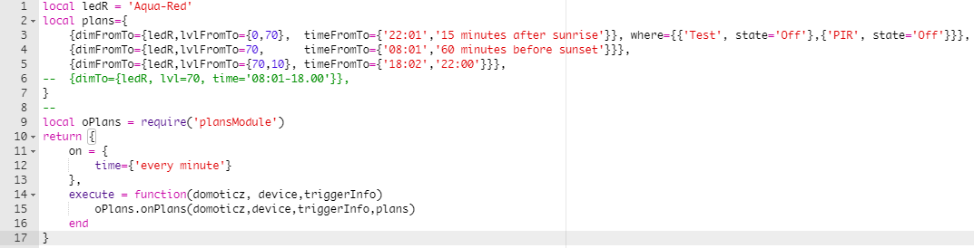

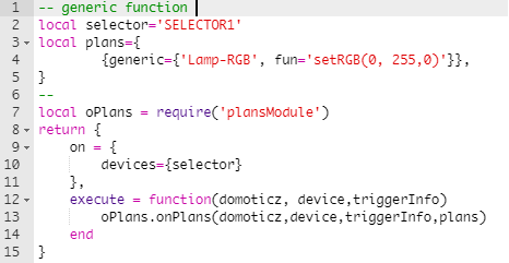

Version 1.8 -Future, new function, generic, openURL, dimFromTo. Now in where You can use OR=true. See example in this topis.

switchOn,switchOff,switchSelector,toggleSwitch,dimTo, updateSetPoint, openURL, dimFromTo
switchOn='test1', switchOff={'test2'}, dimTo={'test3',lvl=10}, switchSelector={'test4',lvl='Level1'}, toggleSwitch={{'test5'},{'test6'},{'test7'}}
dimTo={'test10',lvl=10, when='temperature < 10'} , switchOn={{'test20', when='temperature > 20}, 'test21'}
switchOn={'test40', fun='checkFirst().forSec(5)'}, {onDevice='test1', updateSetPoint={'Temperatura WYJAZD',setPoint=23}},

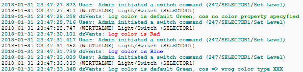

debug: debug="debugin rules nr 1 >>>' . Log more information about excecution current rule.

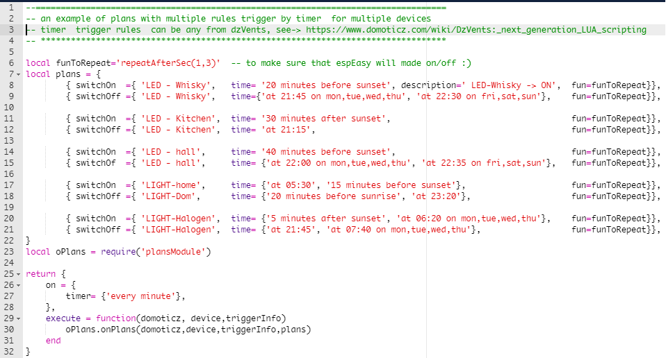

Next egzample of simple plans with multiple rules trigger by timer for multiple devices
-- an example of plans with multiple rules trigger by timer  for multiple devices
-- timer  trigger rules  can be any from dzVents, see-> https://www.domoticz.com/wiki/DzVents:_next_generation_LUA_scripting
local funToRepeat='repeatAfterSec(1,3)'  -- to make sure that espEasy will made on/off :)
local plans = {
        { switchOn  ={ 'LED - Whisky',   time= '20 minutes before sunset', description=' LED-Whisky -> ON',  fun=funToRepeat}},
        { switchOff ={ 'LED - Whisky',   time={'at 21:45 on mon,tue,wed,thu', 'at 22:30 on fri,sat,sun'},    fun=funToRepeat}},
        { switchOn  ={ 'LED - Kitchen',  time= '30 minutes after sunset',                                    fun=funToRepeat}},
        { switchOff ={ 'LED - Kitchen',  time= 'at 21:15',                                                   fun=funToRepeat}},
        { switchOn  ={ 'LED - hall',     time= '40 minutes before sunset',                                   fun=funToRepeat}},
        { switchOf  ={ 'LED - hall',     time= {'at 22:00 on mon,tue,wed,thu', 'at 22:35 on fri,sat,sun'},   fun=funToRepeat}},
        { switchOn  ={ 'LIGHT-home',     time= {'at 05:30', '15 minutes before sunset'},                     fun=funToRepeat}},
        { switchOff ={ 'LIGHT-Dom',      time= {'20 minutes before sunrise', 'at 23:20'},                    fun=funToRepeat}},
        { switchOn  ={ 'LIGHT-Halogen',  time= {'5 minutes after sunset', 'at 06:20 on mon,tue,wed,thu'},    fun=funToRepeat}},
        { switchOff ={ 'LIGHT-Halogen',  time= {'at 21:45', 'at 07:40 on mon,tue,wed,thu'},                  fun=funToRepeat}},
		timer= {'every minute'},

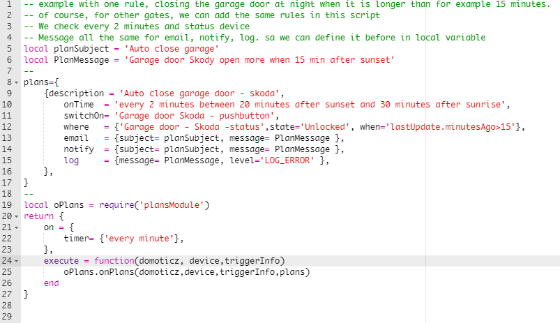

Now We can simple swap device names and change onTime to target.
-- example with one rule, closing the garage door at night when it is longer than for example 15 minutes.
-- of course, for other gates, we can add the same rules in this script
-- We check every 2 minutes and status device
-- Message all the same for email, notify, log. sa we can define it before in local variable
local planSubject = 'Auto close garage'
local PlanMessage = 'Garage door Skody open more when 15 min after sunset'
plans={
    {description = 'Auto close garage door - skoda',
        onTime  = 'every 2 minutes between 20 minutes after sunset and 30 minutes after sunrise',
        switchOn= 'Garage door Skoda - pushbutton',
        where   = {'Garage door - Skoda -status',state='Unlocked', when='lastUpdate.minutesAgo>15'},
        email   = {subject= planSubject, message= PlanMessage },
        notify  = {subject= planSubject, message= PlanMessage },
        log     = {message= PlanMessage, level='LOG_ERROR' },
Of course, with one rule instead of using onTime in a rule, we could set it in the dzVents timer.
But if we have many rules in one script with different times, it can not be done in the dzVents timer. so we have to use onTime function from plansModule

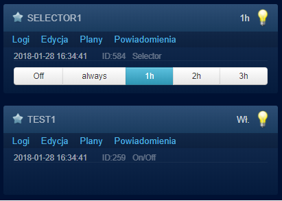

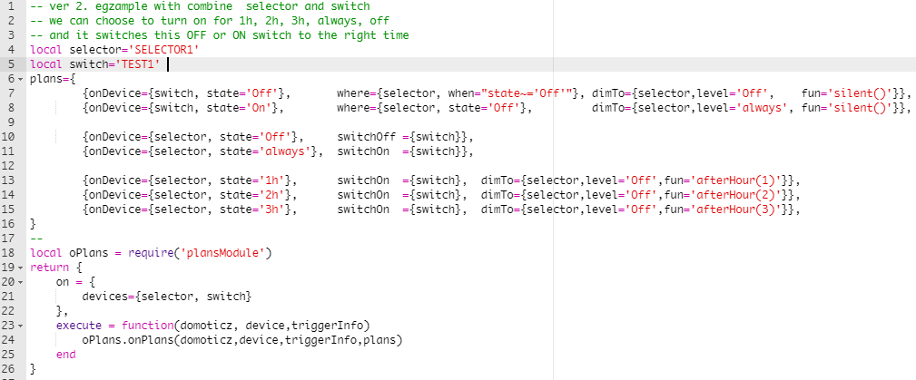

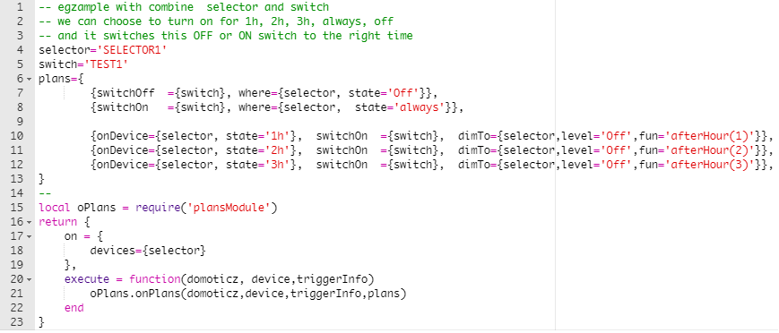

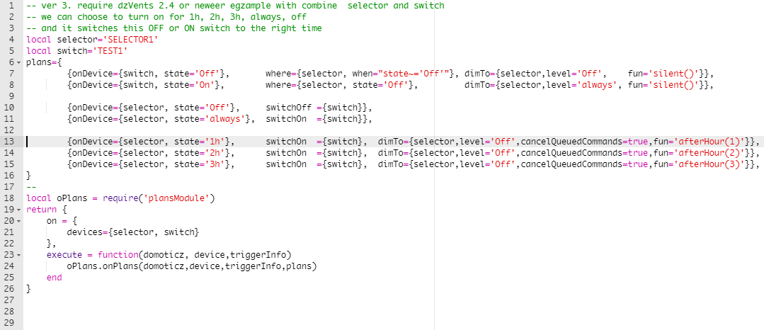

Example with combine selector and switch. We can choose to turn on for 1h, 2h, 3h, always, off and it switches this OFF or ON switch to the right time. When You selected for example 1h - selector back to OFF after 1h and turn OFF switch.
NOTE: for test You can change fun on aferSec(10), 20, 30 etc. Code to copy in spoiler
-- egzample with combine  selector and switch
-- we can choose to turn on for 1h, 2h, 3h, always, off
-- and it switches this OFF or ON switch to the right time
selector='SELECTOR1'
switch='TEST1'
plans={
        {switchOff  ={switch}, where={selector, state='Off'}},
	    {switchOn   ={switch}, where={selector,  state='always'}},
	    {onDevice={selector, state='1h'},  switchOn  ={switch},  dimTo={selector,level='Off',fun='afterHour(1)'}},

ver 2 previous script selector+switch. Now also handle the situation when we click on TEST1 (eg when we operate through a hardware button).
Note: to correct work requires the 1.2 or newer version of the plansModule to be downloaded from the first post
-- ver 2. egzample with combine  selector and switch
local selector='SELECTOR1'
local switch='TEST1'
plans={
	    {onDevice={switch, state='Off'},       where={selector, when="state~='Off'"}, dimTo={selector,level='Off',    fun='silent()'}},
        {onDevice={switch, state='On'},        where={selector, state='Off'},         dimTo={selector,level='always', fun='silent()'}},
        {onDevice={selector, state='Off'},     switchOff ={switch}},
	    {onDevice={selector, state='always'},  switchOn  ={switch}},
	    {onDevice={selector, state='2h'},      switchOn  ={switch},  dimTo={selector,level='Off',fun='afterHour(2)'}},
	    {onDevice={selector, state='3h'},      switchOn  ={switch},  dimTo={selector,level='Off',fun='afterHour(3)'}},
		devices={selector, switch}

Great job Andrzej.
Thanks to this script I have reduced many of my scripts and many lines of code to a few simple commands.
For example, I use such formulas as:
2xRPi - Synology DS212 - RFLink433 - Mi-Light lights - Kaku switches - Conrad RSL wall-mounted switches - Sonoff switches - IP Cameras

Version 1.4 -fix for bug to level in dimTo function. Future: add color to output for debug and as new property to object Log. Default color for log is green.
But now You can change log text from default color green to other. eg, Red, Blue, Green, Black, Brown, etc. See example.
-- colored log.
plans={
    {where={selector, state='Off'},    log={message='Log color is default Green, cos no color property specyfied'}},
    {where={selector, state='always'}, log={message='Log color is Red', color='Red'}},
    {where={selector, state='1h'},     log={message='Log color is Blue', color='Blue'}},
    {where={selector, state='2h'},     log={message='Log color is default Green, cos => wrong color type XXX', color='XXX'}},
		devices={selector}
After run this script and change levels in selector log should look like this

Version 1.5 -Future, add property cancelQueuedCommands for all function. Require dzVents 2.4. See example below
ver 3 previous script "selector+switch". Now also handle the situation when we will change mind and click from shorter time 1h to 2h.
Note: to correct work requires the 1.5 or newer version of the plansModule to be downloaded from the first post
and of course dzVents 2.4 (with cancelQueuedCommands)
-- ver 3. require dzVents 2.4 or neweer egzample with combine  selector and switch
plans={
	    {onDevice={selector, state='1h'},      switchOn  ={switch},  dimTo={selector,level='Off',cancelQueuedCommands=true,fun='afterHour(1)'}},
	    {onDevice={selector, state='2h'},      switchOn  ={switch},  dimTo={selector,level='Off',cancelQueuedCommands=true,fun='afterHour(2)'}},
	    {onDevice={selector, state='3h'},      switchOn  ={switch},  dimTo={selector,level='Off',cancelQueuedCommands=true,fun='afterHour(3)'}},
Text version script's code for copy in spoiler.

Version 1.8:
New function:
1. generic
- the generic function has been added to run all other functions not directly supported by the library but exist in dzVents now and in future.
Of course everything else for the rule with function generic is also allowed as time, when or where
Here is an example of "setRGB(0, 255,0)"
-- generic function
local plans={
	    {generic={'Lamp-RGB', fun='setRGB(0, 255,0)'}},
		devices={selector}

3. dimFromTo
Added special function which is not implemented in dzVents. This function it is used to change the dimmer value depending on the time.
a) syntax:
dimFromTo = {<name>, lvlFromTo = <array {from proc, to proc} or one number>, timeFromTo = {time1, time2}}
b) we can light up, for example, from 10 percent to 70 percent from 22.00 to sunrise. or vice versa (then from proc> to percent)
c) Time parameters you can use all the allowed syntax for dzVents but of course for a given moment. "at" is not necessary.
d) If lvlFromTo is a constant number (or maybe) then the total is the same as regular dimTo, i.e. such records are equivalent to
   {dimFromTo = {ledR, lvlFromTo = 70, timeFromTo = {'08:01', '60 minutes before sunset'}},
   {dimTo = {ledR, lvl = 70, time = 'between 08:01 and 60 minutes before sunset'},
local ledR = 'Aqua-Red'
local plans={
    {dimFromTo={ledR,lvlFromTo={0,70},  timeFromTo={'22:01','15 minutes after sunrise'}}, where={{'Test', state='Off'},{'PIR', state='Off'}}},
    {dimFromTo={ledR,lvlFromTo=70,      timeFromTo={'08:01','60 minutes before sunset'}}},
    {dimFromTo={ledR,lvlFromTo={70,10}, timeFromTo={'18:02','22:00'}}},
--  {dimTo={ledR, lvl=70, time='08:01-18.00'}},
		time={'every minute'}
