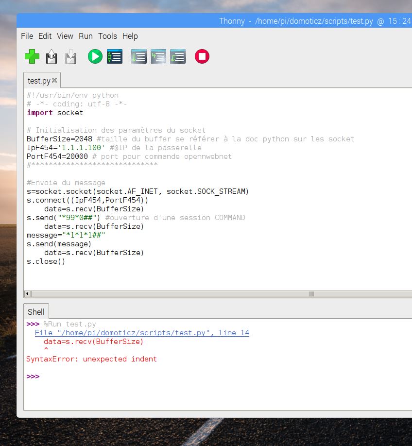

:cry: :cry: :cry: :cry:
SyntaxError: unexpected indent
python problema.JPG (99.23 KiB) Viewed 4859 times

As indicated by the error, your problem is indentation.
You must delete the spaces at the beginning of the 3 lines:
data=s.recv(BufferSize)
I have tried the script and it works correctly.

spugna85 wrote: Friday 16 March 2018 1:57 As indicated by the error, your problem is indentation.

I do not know how to help you, I tried the script on Windows with pyton 3.6.
it seems like the send function does not want a string parameter. maybe it depends on the version of pyton used? I do not know..
