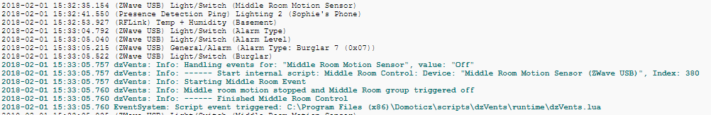

I'm experiencing something similar and seeing that the dzvents or lua script events are not starting until nearly 1 second after the event has occured. I'm using a Fibaro Multisensor (v3.2 version) and a Zwave.me Uzb on Windows 7 machine with the latest version of Domoticz. See pic below
There is also another issue with the Multisensor where the Burglar sensor is triggered with the PIR sensor but I've been unable to resolve this, seems that this is a common issue with the v3.2 version.
Any ideas how to reduce this latency? I heard that pass2php might be quicker but this looks difficult to setup on Windows.

Re: Delay from motion sensor
30 seconds for response? OMG. Are you sure your scripts are set correctly?
Pass2php should be possible on Windows with something like XAMPP.
