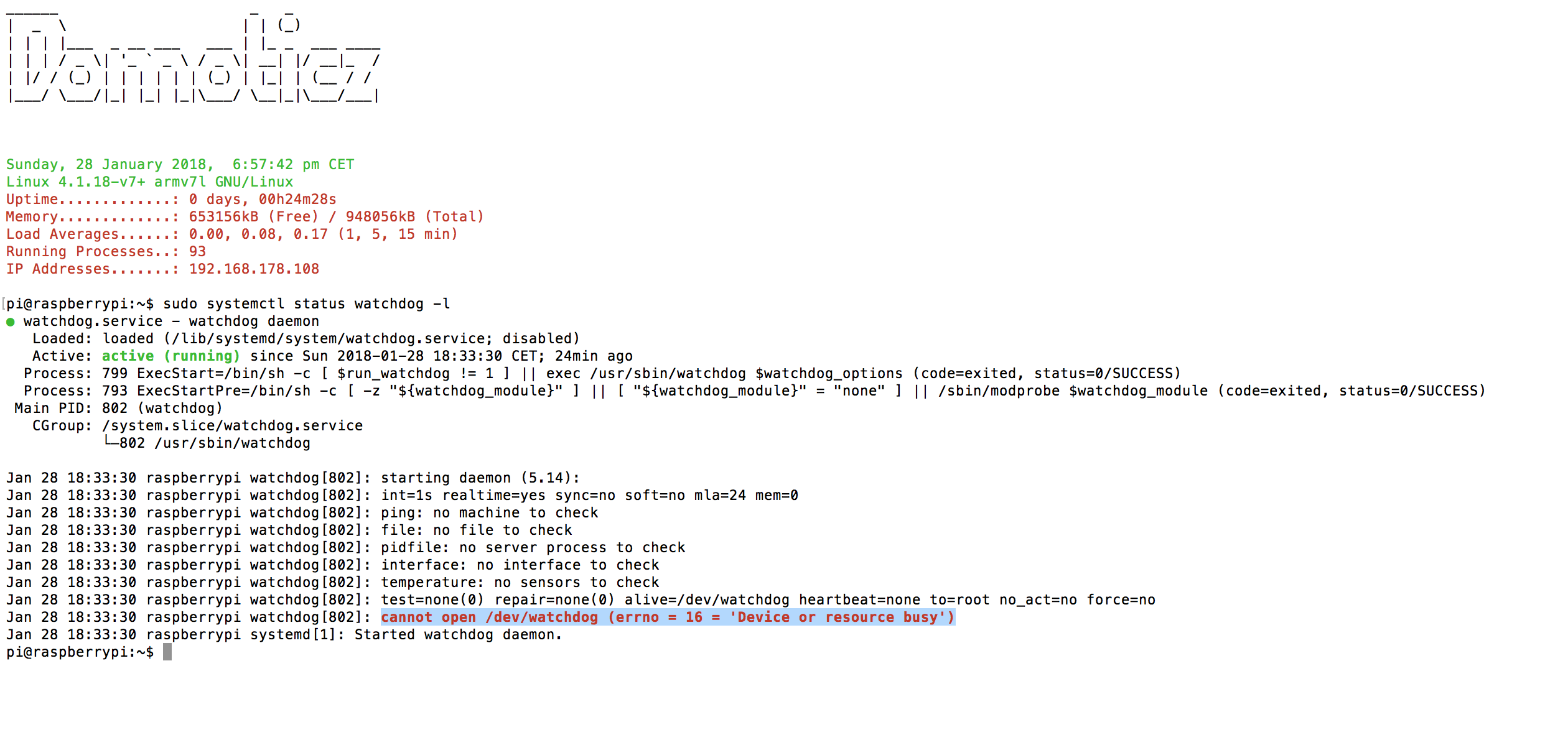

I overlooked all about watch dog and I successfully have it running and also have it automatically start up after a restart.
Only one problem accused after: sudo systemctl status watchdog -l
It contains a message: "cannot open /dev/watchdog (errno = 16 = 'Device or resource busy')" at one of the row.
See the picture for details.
So I can see watchdog is running and also starts after a restart.
Can anyone help me to solve this.
Looking on Google did not give me the solution.

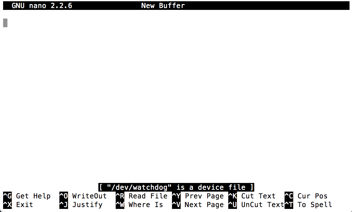

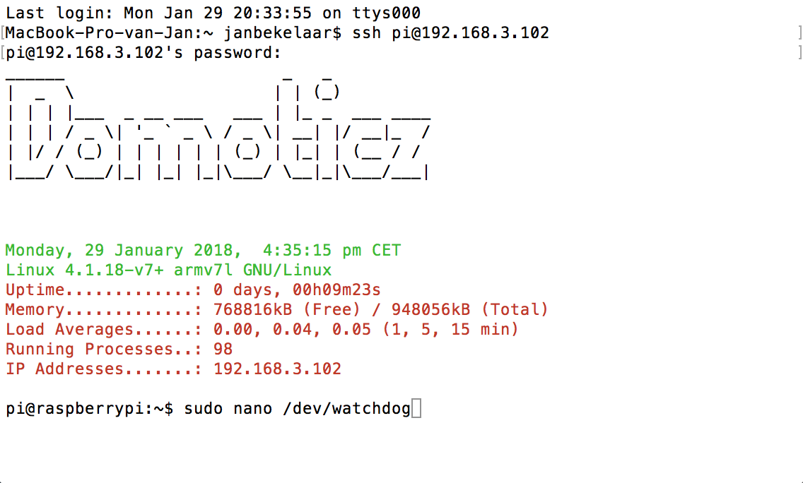

When I typ " sudo nano /dev/watchdog" it says it is a device file which is empty (see both pictures 1 and 2).
Do I have to put: crw------- 1 root root 10, 130 Jan 14 11:28 /dev/watchdog in that empty file?

Thanks for your fast reaction...super
