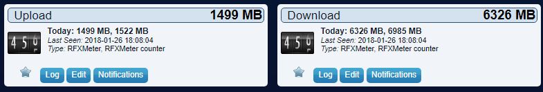

To see if all is working I enabled the rsync feature to replicate data from and to a remote location.
This to emulate upload and download.
The script is running on the router itself and posts the data to 2 virtual sensors (COUNTERS).
At the moment it runs every minute or so, but that can be changed to every 5 minutes or every hour.

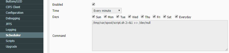

You will only have to run it every x minutes or so via: administration -> scheduler.
/tmp/var/spool/script.sh 2>&1 >> /dev/null
