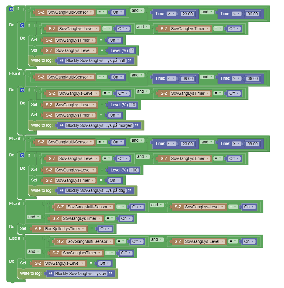

I might be misunderstanding Stan, but I dont think he is quite correct. To nest an if-block you have to use the if's with a gear on them. The other if-blocks cant be nested that way. I attaching one of my rules, where I had to add nested if-blocks to get it to work correctly. But I agree though, the else-if's blocks is a bit wonky at times.
Have you tried moving the send notification inside the nested if-block? Perhaps try changing the top if-block to the one with the gear as well?
Blockly turing on a light with different intensity, depending on time of day.
