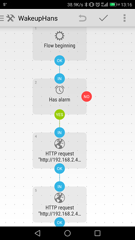

The flow in Automate is just 4 blocks and looks like this:
The HTTP requests are as follow:
http://192.168.0.10:8080/json.htm?type=command&param=updateuservariable&vname=Alarmtime&vtype=integer&vvalue=" ++ alarm
'alarm' in the above command is a variable I get from the second block.
http://192.168.0.10:8080/json.htm?type=command&param=switchlight&idx=84&switchcmd=On"
