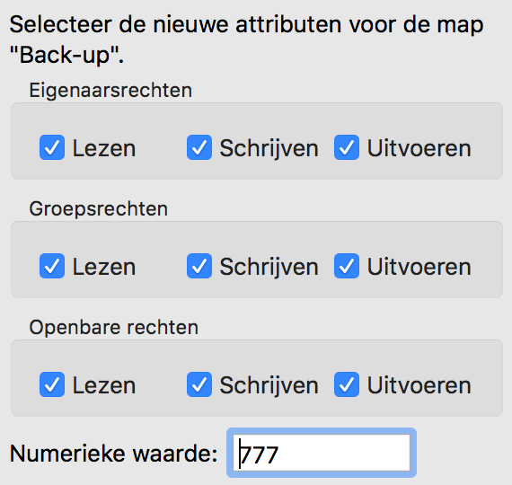

hi
i have trouble with the script can someone help me??
i get this error??
changed password to xxxx
if there needs to be more info please ask...
is my second script ever i started trough the wiki page so...
greets marco

Hi everyone,
I'm using the back-up script for a few months now, to make a back-up of domoticz every night a send it to my nas.
Making the back-up, and put it on the nas works fine, but I received a error with the extension of automated pruning.
The error occurred says line 46: dirlist: acces denied. But the domoticz user, has full rights for acces the directory. Can someone help me?
