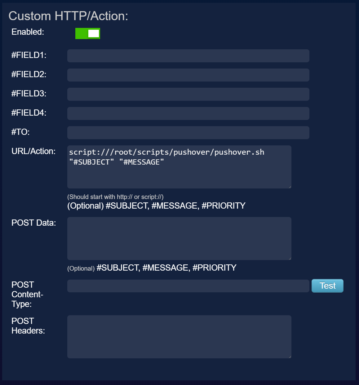

2) In Domoticz settings on the Notifications tab make sure Pushover is disabled, then enable "Custom HTTP/Action:"
Fill out the settings as below changing the path to the path of your bash script as necessary:
script:///root/scripts/pushover/pushover.sh "#SUBJECT" "#MESSAGE"
pushover domoticz http action.PNG (76.29 KiB) Viewed 2453 times
Press "Test" and you should get a notification on your phone then don't forget to press "Apply Settings" at the top of the page.
