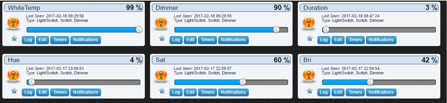

I created a few "virtual" dimmer switches
Dimmer Switches.png (256.5 KiB) Viewed 6771 times

        --there are changes in the settings, so estimate the values for each type of the bulbs
	    TempValue = otherdevices_svalues[TempDevice];
	    BriValue = otherdevices_svalues[BriDevice]
	    SatValue = otherdevices_svalues[SatDevice]
	    HueValue = otherdevices_svalues[HueDevice]
	    DimValue = otherdevices_svalues[DimDevice];
	    DurationValue = otherdevices_svalues[DurationDevice];
	    --to prevent errors for nil values when initiated
        if TempValue==nil then TempValue=0 end
        if BriValue==nil then BriValue=0 end
	    if SatValue==nil then SatValue=0 end
	    if HueValue==nil then HueValue=0 end
	    if DimValue==nil then DimValue=0 end
	    if DurationValue==nil then DurationValue=0 end
	    if debug then print("Temp = " ..TempValue.." Dim = "..DimValue.." Bri = "..BriValue.." Sat = "..SatValue.." Hue = "..HueValue.." Duration = "..DurationValue) end
	    --determine the duration of the transation, 100% = 100 seconds, 10% = 10 seconds, 1% = 1 sec
        if DurationValue == 0 or DurationValue == nil then
            DurationHueValue = 4    --standard transation time Hue = 400 ms
            DurationYeeValue = 400  -- make Yeelights have the same value as Philips Hue Lights
            DurationHueValue = DurationValue * 10       -- Hue Transation time is defined in 0,1 sec
            DurationYeeValue = DurationValue * 1000     -- Yee transation time is in ms = 0,001 sec
        --color changes
        BriHueValue = round(tonumber(BriValue * 2.55),0);
        SatHueValue = round(tonumber(SatValue * 2.55),0);
        HueHueValue = round(tonumber(HueValue * 655.35),0);
        BriYeeValue = tonumber(BriValue)
        SatYeeValue = tonumber(SatValue)
        HueYeeValue = round(tonumber(HueValue * 3.59),0);
        --white changes
        --Yeelight Temp between 1700 and 6500 Kelvin
        WhiteYeeValue = ((TempValue-1) * 48)+1700;
        DimYeeValue =  tonumber(DimValue)
        --Huelight value between the warmest color 2000K is 500 mirek ("ct":500) and the coldest color 6500K is 153 mirek ("ct":153)
        WhiteHueValue = 500 - round(tonumber(TempValue * 3.47),0)
        DimHueValue = round(tonumber(DimValue * 2.55),0)
        if (devicechanged[HueDevice]=='Off' or devicechanged[SatDevice]=='Off' or devicechanged[BriDevice]=='Off' or
            devicechanged[TempDevice]=='Off'or devicechanged[DimDevice]=='Off') or
		    (tonumber(otherdevices_svalues[BriDevice]) ==0 or tonumber(otherdevices_svalues[SatDevice])==0 or tonumber(otherdevices_svalues[HueDevice])==0 or
		        tonumber(otherdevices_svalues[TempDevice])==0 or tonumber(otherdevices_svalues[DimDevice])==0 ) then
			-- the bulb is Off
			HueOff()
			YeelightOff()
		if devicechanged[TempDevice] or devicechanged[DimDevice] then
		    --there was change at Lighttemperature setting so we need to send that commands
			HueTemperature(WhiteHueValue, DimHueValue, DurationHueValue)
            YeelightTemperature(WhiteYeeValue, DimYeeValue, DurationYeeValue)
		    --there were changes in the color settings so send the proper commands for that case
			HueHue(HueHueValue, SatHueValue, BriHueValue, DurationHueValue)
			YeeHue(HueYeeValue, SatYeeValue, BriYeeValue, DurationYeeValue)
    if devicechanged[SelectorDevice1] then
        if otherdevices['HueSun'] == 'On' then commandArray['HueSun'] = 'Off' end
        if otherdevices['Staande schemerlamp'] == 'Off' then commandArray['Staande schemerlamp'] = 'On' end
        HueOn()
        YeelightOn()
        print("selectorswitch")
        if otherdevices[SelectorDevice1] == "Energize" then
            commandArray[TempDevice]='Set Level 99'
            commandArray[DimDevice]='Set Level 90'
        if otherdevices[SelectorDevice1] == "Concentrate" then
            commandArray[TempDevice]='Set Level 77'
            commandArray[DimDevice]='Set Level 80'
        if otherdevices[SelectorDevice1] == "Reading" then
            commandArray[TempDevice]='Set Level 44'
            commandArray[DimDevice]='Set Level 70'
        if otherdevices[SelectorDevice1] == "Normal" then
            commandArray[TempDevice]='Set Level 37'
            commandArray[DimDevice]='Set Level 60'
        if otherdevices[SelectorDevice1] == "Relax" then
            commandArray[TempDevice]='Set Level 16'
            commandArray[DimDevice]='Set Level 10'
        if otherdevices[SelectorDevice1] == "Movie" then
            commandArray[TempDevice]='Set Level 100'
            commandArray[DimDevice]='Set Level 30'
        if otherdevices[SelectorDevice1] == "Romantic" then
            commandArray[TempDevice]='Set Level 12'
        --[[ some test results for later reference
        HUE SAT BRI - description
          4  60  42 - rose
          7  65  19 - yellow-ish
          3  65  19 - orange /red
         10  65  19 - yellow/green
         20  65  19 - green/yellow
         30  65  19 - green
         40  65  19 - green/blue
         50  65  19 - bue/green - light blue
         60  65  19 - blue
         70  65  19 - deep blue
         76  65  19 - night blue
         80  65  19 - purple
         90  65  19 - purple / red
        100  65  19 - red
        if otherdevices[SelectorDevice1] == "Warm" then
            commandArray[HueDevice]='Set Level 4'
            commandArray[SatDevice]='Set Level 60'
            commandArray[BriDevice]='Set Level 42'
        if otherdevices[SelectorDevice1] == "NightBlue" then
            commandArray[HueDevice]='Set Level 76'
            commandArray[SatDevice]='Set Level 65'
            commandArray[BriDevice]='Set Level 19'
        if otherdevices[SelectorDevice1] == "Warm-Dimmed" then
            commandArray[HueDevice]='Set Level 99'
        if otherdevices[SelectorDevice1] == "Off" then
        	HueOff()
			YeelightOff()
return commandArray
Best regards Bert
