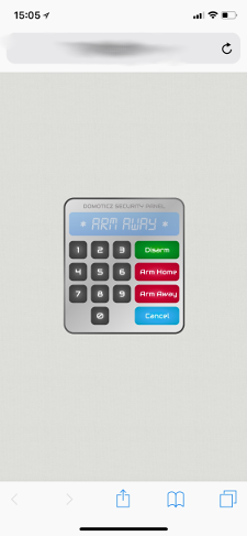

I can see some room for further improvement, as follows: -
  1. auto-adjust keypad size to fill the screen (see image below, for the current state - not fat-finger friendly)

Keypad size as displayed
Keypad zoomed to fill available screen
Traditional alpha-numeric phone-style keypad
