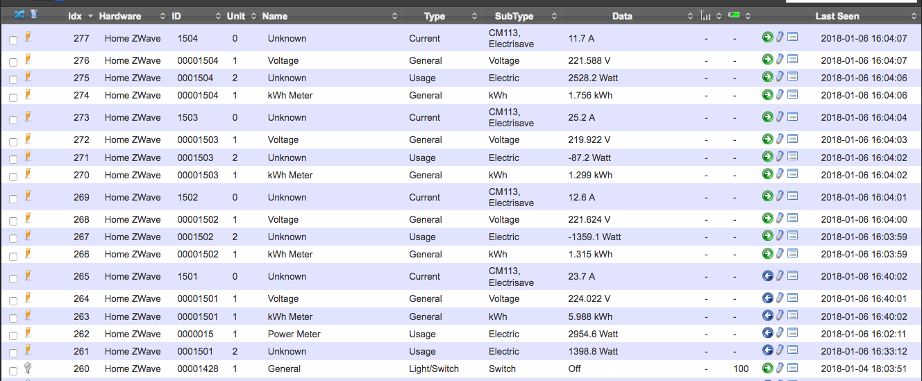

i need help with Aoetec Gen5 Home Energy Meter 3 Phase 4 wires model.
Screen Shot 2018-01-06 at 16.41.14.png (204.78 KiB) Viewed 360 times
Does negative watts mean i set the clamps reverse (Index 267 and 271) ? do i need to correct them?

I am afraid you are the only one that can answer :)
If you have solar panels on that circuit or another generating object it could be negative as the current is reversed in some cases
If you are consuming only (eq yoy get power from grit or circuit connected before the measurement) it should be positive.
So the Wattage is depending on the current directio * voltage (W=U * I --> Watt = Voltage * Ampere)
Hope the above helps you a bit with your question.
