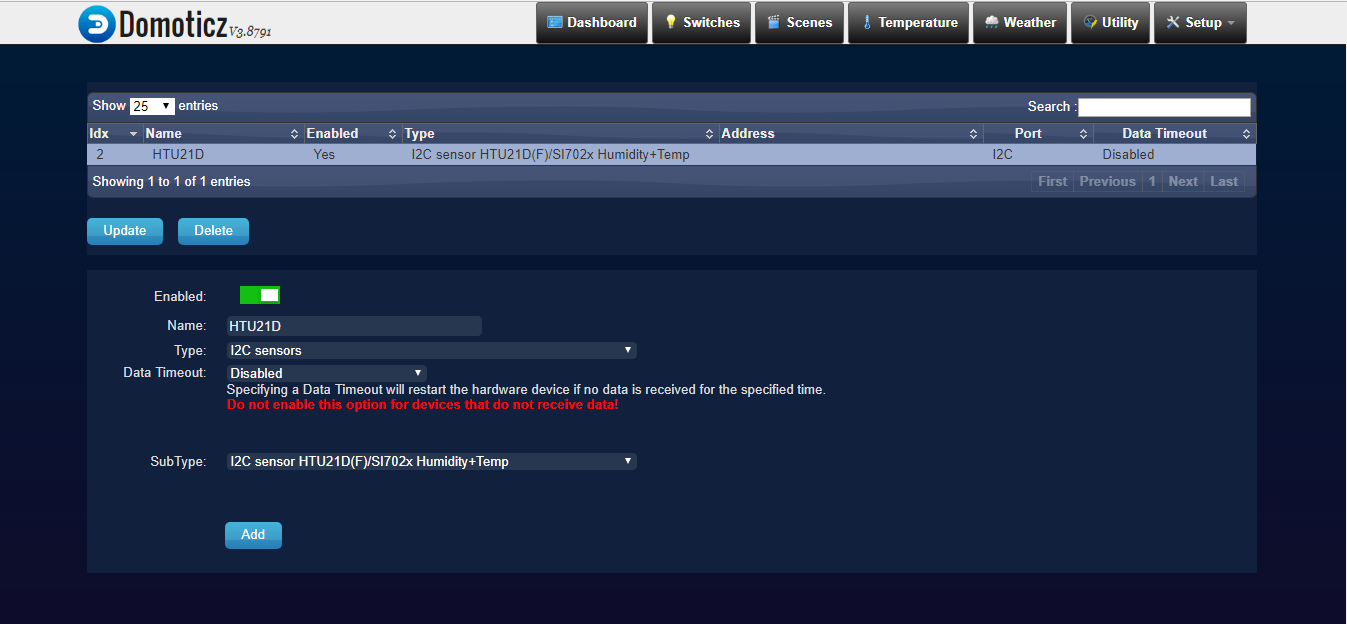

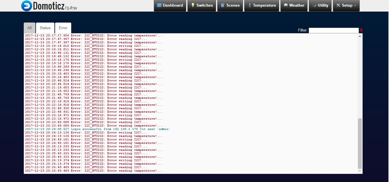

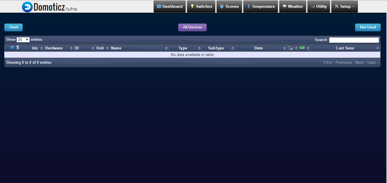

okay,upgraded to Version: 3.8791 and updates library.Now can see GUI server.
http://www.instructables.com/id/Detect- ... berry-Pi-/
Can see Temperature/Humidity on RPi 2B+.Added to server hardware (see screen capture's).
Can see in device's.
Please help
Please help

Show here output temp and hum off the command line.

The link above worked RPI2b for sensor value but does it need extra code to output code i2c.I was able to use python HTU21d from git hub.With command line outputs looking okay.So frustrating , can some provided a idiot's guide.
