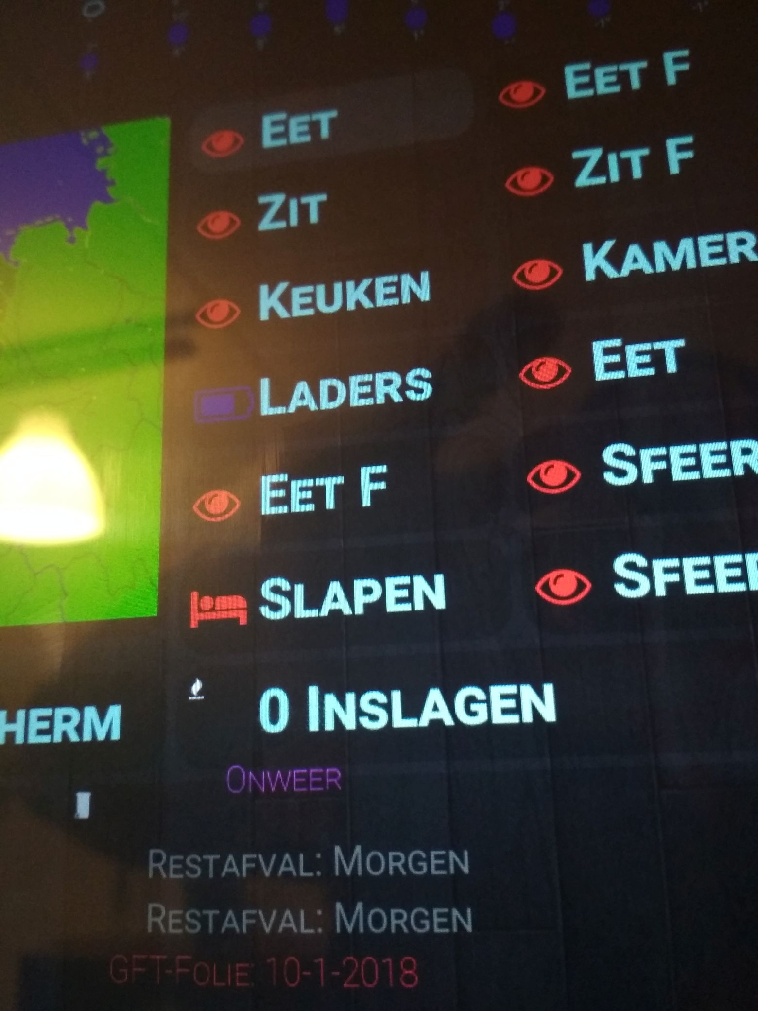

mm thanks for the typo..
Only the image is see very small in my setup.
And no color and i set the color on true in the config:
config['garbage_use_names'] 	= true;
config['garbage_use_colors']	= true;
config['garbage_icon_use_colors'] = true;
Just a very smal "kliko" in the left upper corner. without a color...
And i see in the img. map all the jpg that he can should use.

Derik
Posts: 1605
Re: Dashticz - Module - Garbage collector
Post by Derik »
This is what i have..
Perhaps you can share your settings?

Derik wrote: Tuesday 02 January 2018 18:08 klein.jpg
Ah, I thought no css at all was working, but it is only the image. Use
div.col-icon { width: 100px !important;}
in your custom.css to also adapt the div around the icon. That one is by default fixed to max 50px width. (by using the 'inspect element' option in your browser and playing around with the elements you can see what happens if you disable on change css values)
Contributor to Dashticz
More on my Github profile
