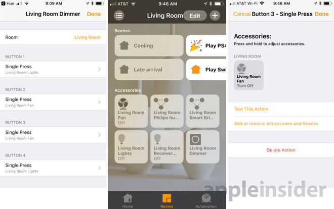

Post by theo69 »
sylar wrote: Tuesday 25 April 2017 21:31 Hello,
I'm playing with eDomotiz, trying to find out what I will be able to do with it. Seems very impressive!
I do have some questions:
- first, regarding switches. For instance, I have set up a virtual "Push On Button" and added it to my Homekit room (SwitchTypeVal: 9 in Domoticz). It does appear on my iPhone in Home application, but only as a standard switch, and I can turn it on or off like any other switch. I would really need to use it as a push button, which is off by default, and is turned on temporarily when I click on it. Is it possible?
- I have also set up virtual temp+humidity sensors, whose values are refreshed by a LUA script computing mean temperatures and humidity in my house. Everything seems OK in Domoticz, while I only have access to the temperature on my iPhone, humidity is missing. Is it normal?
Thanks for your help!
Hi did you solve this problem? Having the same issue. Also looking for double click etc.

Post by theo69 »
How do I change a generic Button to Push Switches - Domoticz SwitchTypeVal: 9 just dont get it...

Post by islandman »
Would it be possible to add push button (selector Button) to the plug-in. Its supported by HomeKit. One example how they could behave are the Logitech Pop Button. I have the Aqara Button with click and double click, they behave basically the same.
Just a Idee.

Re: homebridge-edomoticz Plugin
Post by Marci »
islandman wrote: Tuesday 23 January 2018 14:21 Would it be possible to add push button (selector Button) to the plug-in. Its supported by HomeKit. One example how they could behave are the Logitech Pop Button. I have the Aqara Button with click and double click, they behave basically the same.
Just a Idee.
It’s not a matter of whether it’s supported by HomeKit, it’s a matter of whether Domoticz’ JSON output differentiates / is specific enough to uniquely identify the device type and it’s characteristics to match with the Apple HomeKit spec. See the first post of this thread for how to get the JSON output for a device. Only once that has been looked at can anyone say whether support for your pushbutton device can be added or not.
