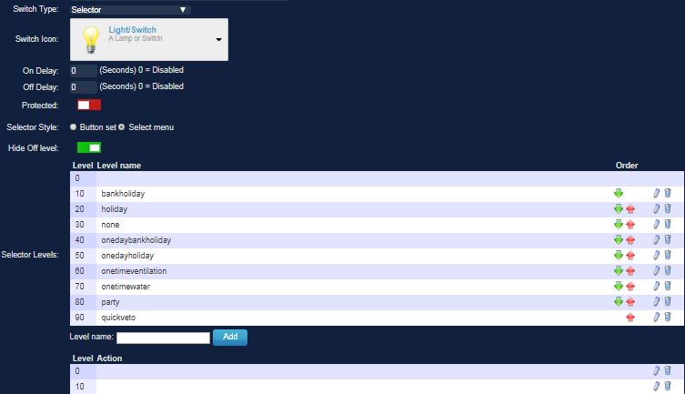

Found an issue with Hc1SFMode.
Here will be added a Switch/selector with right pulldown options.
But the values are wrong (by Domoticz design it is "level" 0...90) but should be:
"values": { "0": "none", "1": "party", "2": "onedaybankholiday", "3": "onedayholiday", "4": "holiday", "5": "bankholiday", "6": "quickveto", "7": "onetimeventilation", "8": "onetimewater" }
So it can not be modified by this selector without a "translation" in the plugin.
Even if the write operation will work - the values will be wrong.
Michael Pruefer

micha_pr wrote: Sunday 31 December 2017 10:51 Found an issue with Hc1SFMode.
Here will be added a Switch/selector with right pulldown options.eBus_plugin.JPG
I'm not sure to understand the issue. By design, Domoticz want selector switch values from ten to ten. Then, when you write the selector switch level, the plugin translates to the expected values by ebusd (you can look at the way dOptionsMapping and dReverseOptionsMapping are used in plugin.py). You can enable the debug mode to check that this is translated as expected.
