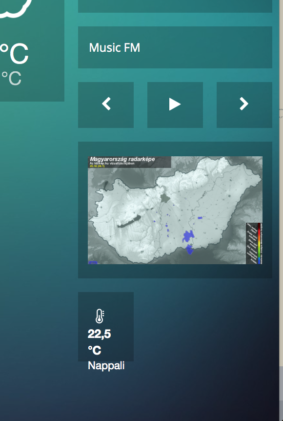

1, In the sidebar it is possible to make temperature box bigger? It looks ugly:
Screen Shot 2017-12-18 at 20.32.11.png (385.74 KiB) Viewed 3448 times

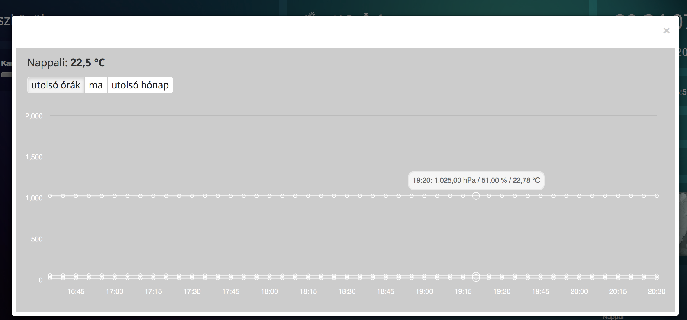

2, when I click on this box, in the popup I see a very straight line:
Screen Shot 2017-12-18 at 20.34.05.png (252.8 KiB) Viewed 3448 times
Unfortunately the current library for the graphs doesn't support multiple Y-scales. And since the barometer is around 1000, the temperature and humidity get very small.
Contributor to Dashticz
More on my Github profile
