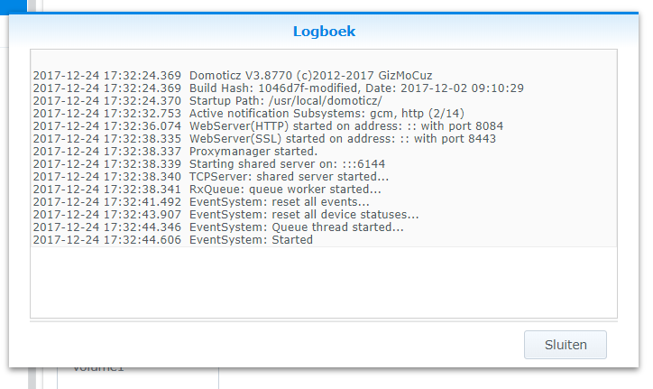

Go to /usr/local/domoticz/var from ssh and check the content of domoticz.log file for errors.
thanks you mean this? What is not good here?
febalci
Posts: 331
Joined: Monday 03 July 2017 19:58
Re: How to install Domoticz on a Synology NAS
Post by febalci »
RR1974 wrote: Monday 25 December 2017 10:12 What is not good here?
Everything seems OK, the file itself may hold more information, but as i stated before, your port is 8084 for domoticz. So, you either have to connect with http://your_synology_server_ip:8084 or https://your_synology_server_ip:8443.

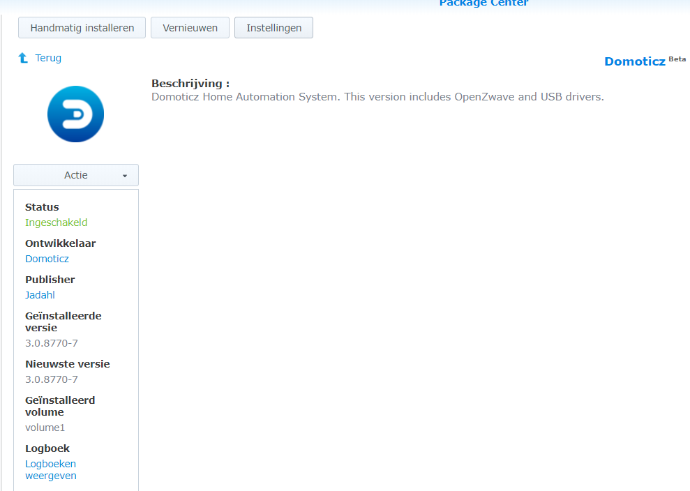

HereImage
Verstuurd vanaf mijn SM-G955F met Tapatalk
febalci
Posts: 331
Post by febalci »
Rr1974, you cannot see domoticz gui from synology nas. You should use firefox or chrome from another pc on your network.
