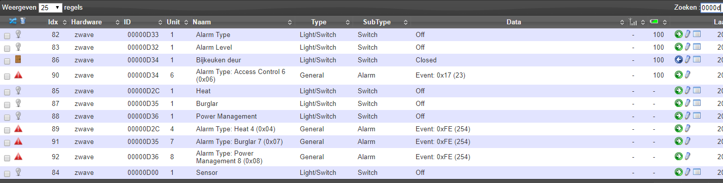

I have bought the Fibaro doorsensor version 2 with temperature sensor buildin and i'm using domoticz on synology.
I have succesfully added the device to domoticz and the sensor switches when the door goes from open to closed and visaversa.
The only device that is usefull is device 00000D34, all other devices are static and for me unclear what the function is about these devices.

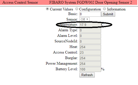

The new fibaro doorsensor has a buildin temperature but in domoticz the Heat sensor is listed as a switch (00000D2C) but in the Z-wave panel you could see the temperature. So it is working in the z-wave panel but not correctly listed in domoticz.
Does anyone know what the purpose is of all these devices and how it is possible to change the Heat from switch to a Temp ?
