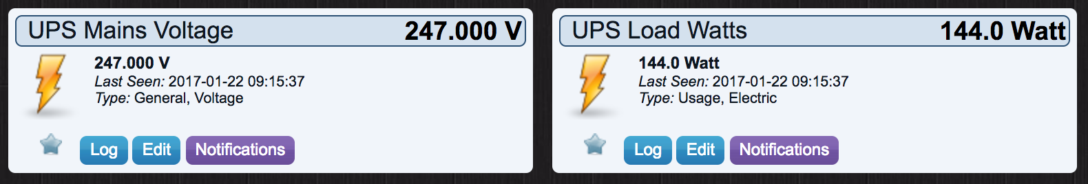

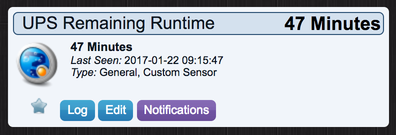

Linux script for getting data from CyberPower PowerPanel software into Domoticz:
Screen Shot 2017-01-22 at 9.15.43 am.png (96.82 KiB) Viewed 4722 times
Screen Shot 2017-01-22 at 9.15.50 am.png (75.77 KiB) Viewed 4722 times
