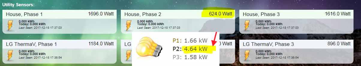

Has someone made script for OWL energy meters for Domoticz?

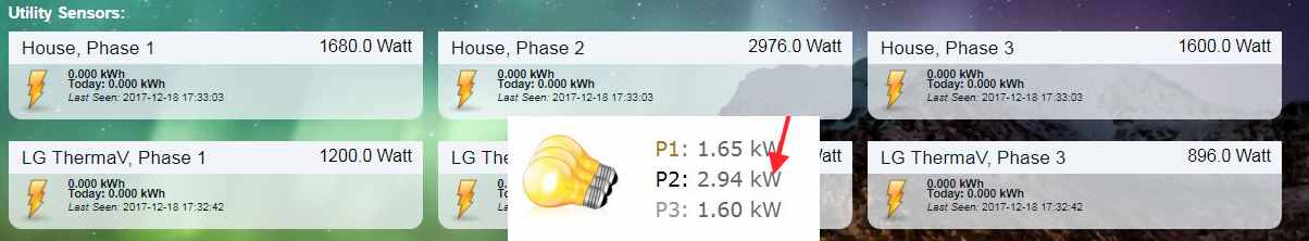

I have 2pcs of OWL Intuition lc with CM180i transmitter (3 phase clamps) and those already stream data to RFlink, but when the consumption per phase is high ( like >4000W as example) the reported value drops lower than 1000W from Rflink to Domoticz. I have reported the issue to Frank Zirrone with some datalogging, but the issue is not solved yet.
So, in order to make events based on consumption I would like to get real values from my house consumption.
I do not have any programming skills execpt "copy & paste" :)
I wonder has anyone made a "script" to be shared with explanation "how to"?
Shall Domoticz have native support for these Network connected OWL consumption meters?

OWL Website compared to RFlink Domo value
High Cons Domoticz trough RFlink Not Ok anymore.JPG (31.39 KiB) Viewed 1352 times
still ok Domoticz trough RFlink.JPG (30.26 KiB) Viewed 1352 times
