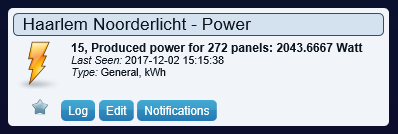

I wrote a plugin to get data from a SolarEdge Public Dashboard. Unfortunately I was not able to get the current power, but only the produced power during the last 15 minutes. In the plugin the device is created with:
Domoticz.Device(Name="Power", Unit=1, TypeName="kWh").Create()
The device is updated with the standard procedure:
Devices[Unit].Update(nValue=nValue, sValue=str(sValue))
In Domoticz I get the device as:
I have 2 question:
1. I expected to get the nValue (=15) in to top right corner. Now nValue and sValue (='Produced...Watt') are both shown as text.
How do I get nValue in the top right corner?
2. If I click on the Edit button, change Type from Usage to Return and click on Update, the change is not updated, so also the icon will not change.

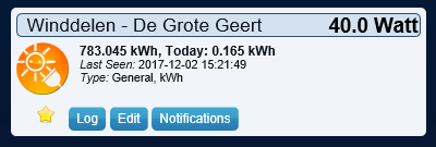

How can I enable the possibility to change the Usage or how can I change the icon as shown in:

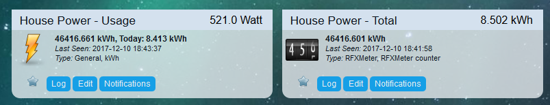

For my power measuring plugin i used
Domoticz.Device(Name="Usage", Unit=1, Type=243, Subtype=29, Switchtype=0, Image=0, Options="").Create()
Domoticz.Device("Total", 2, 113).Create()
and got
not sure if that helps
