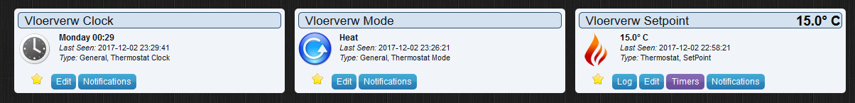

I just received a Topvico floor thermostat with Zwave and was wondering of anyone has got this working. I included the device and it is recognized as thermostat, with time setting, setpoint, on/off and clock program.
But the only thing that seems to work is switching it off and on, if I change the setpoint, nothing updates in the thermostat, also it does not react to the clock program, and if I try to set the day/time, I get an error saying that the time setting did not finish, and the hours always set to 0, no matter what I enter, the minutes seem to set fine, but only after I touch any of the buttons on the thermostat, not sure if there is even a day setting.
The specs say it works with both fibaro and vera, so I guess it should be able to work with domoticz?
I have also tried setting polling to on but that did not change anything.
