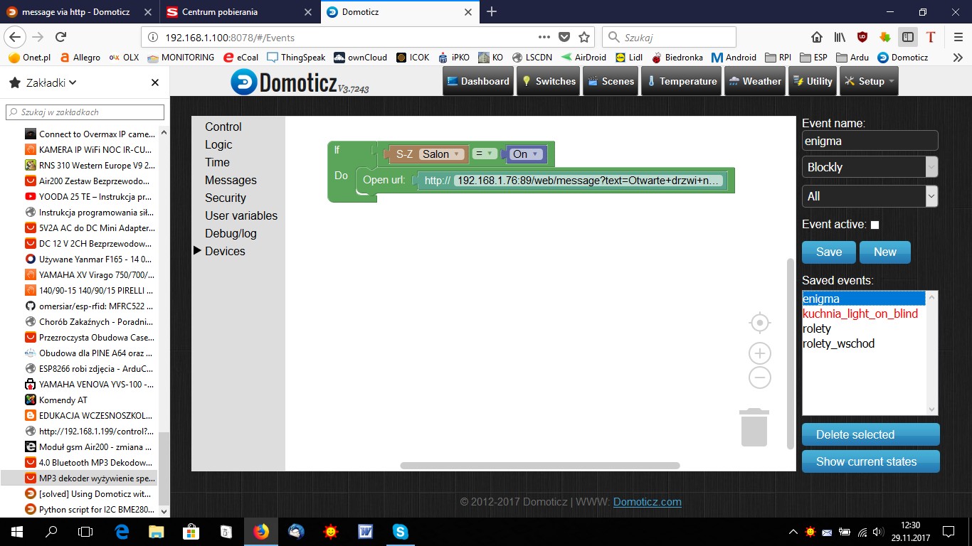

You have to do this by using events

I tried it as in your example, but I still get the error in the log error opening url. I also tied it with the port 89 as in your example, same error.
When I do it from my browser on my pc it works. Do I need to install anything additional on my raspberry / domoticz?

Thanks, it works. I had to mask the blanks in the url.
