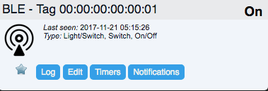

Plugin allows you control availability bluetooth beacons and supports multi-scanners for better place coverage.
Features:
- RSSI threshold on each beacon
- Timeout settings
- Supports several BLE scanners
- Battery check of each beacon with RSSI threshold + time to check + attempts to check in selected period of time
Plugin can be found here: https://github.com/mrin/domoticz-bt-presence
Consists of:
- Domoticz plugin: Manage beacons availability by timeout. Contains UDP server for receive data from several scanners.
- Bluetooth LE scanner: for listening of beacons, check battery level and sending info to the domoticz plugin through UDP.
