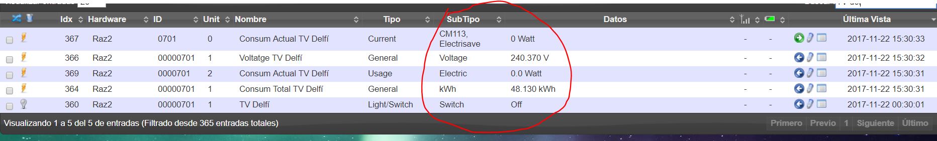

Post by delfisastre »
Yes, and works perfectly.

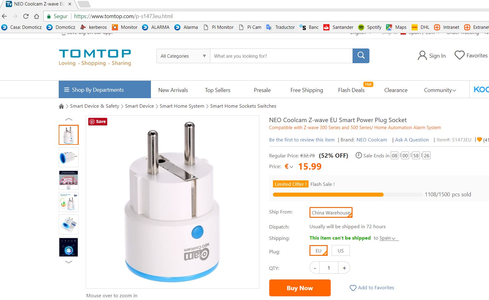

On the website www.tomtop.com it's cheaper!!!

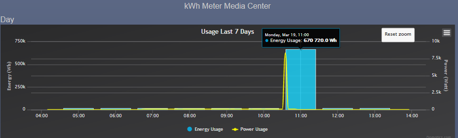

Post by at4500 »
SW: Domoticz beta: V3.9052
Build Hash: 927ba005
Build Date: 2018-03-18 09:38:55
HW: Aeotec Z-Stick Gen5, Z-Wave Plus USB to create gateway
HW: Raspi2
When first and only node operated, it was all fine. When introduced +1 Zwave plug, then started some bogus readings.
+Enabled polling.
+Power conso reporting 3%
+Delay 30sec.
-Didnt really help, will need to embrace myself and so exclude all, reinclude all.
Also, can be related to this Domoticz error. as there is a gap in zwave logs
==> user.log <==
Mar 20 08:53:49 domoticz: Warning: Notification NOT handled (type: F3 - General, subtype: 28 - Counter Incremental), please report on GitHub!
==> messages <==
Mar 20 08:53:52 domoticz: Warning: Notification NOT handled (type: F3 - General, subtype: 28 - Counter Incremental), please report on GitHub!
==> syslog <==
==> user.log <==
Mar 20 08:53:56 domoticz: (zwave) General/kWh (kWh Meter Gas Boiler)
2018-03-20 08:53:44.777 Detail, Node006, Notification: Notification - TimeOut
2018-03-20 08:53:54.126 Detail, Node006, Received: 0x**, 0x**, 0x**, 0x0*, 0x00, 0x**, 0x**, 0x**, 0x02, 0x**, 0x**, 0**0, 0x00, 0x01, 0x**, 0x00, 0x15, 0x00, 0x00, 0x01, 0xc3, 0xa7
