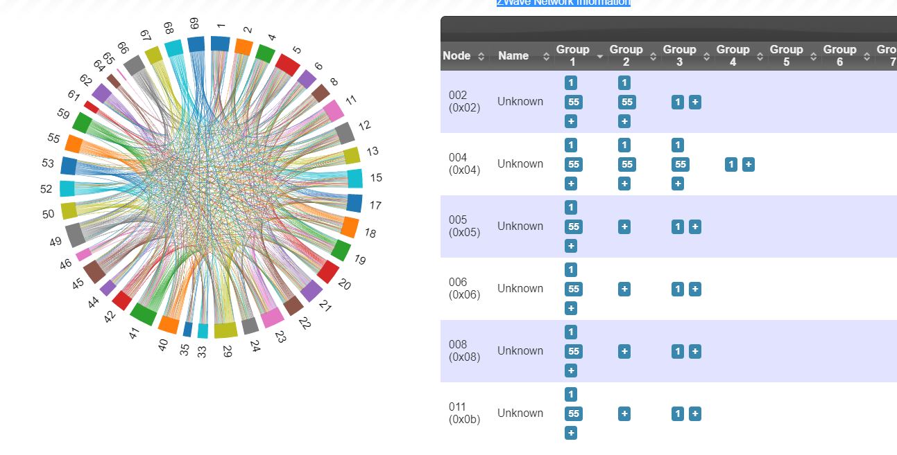

Despite that I have associated the nodes with both main and secondary controller (node 1 resp 55) the secondary dont get updated with manual or main controller changed status.
What have I missed? I add some screen shots below.
