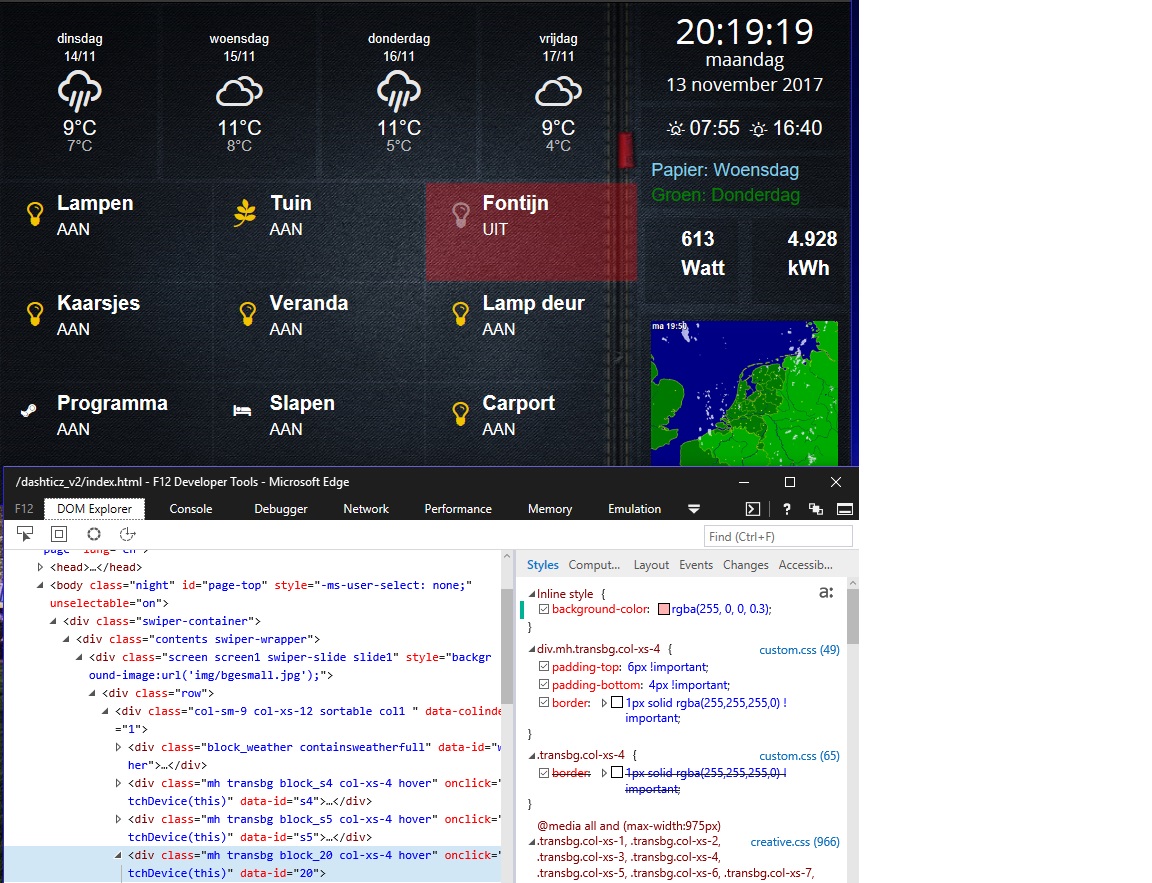

I got a css question, how can I set the background color of the entire block?
I placed an inline red color on the 'Fontijn' block as an example, but I cannot find how to do this by using custom.css
All -selected- blocks should become green (rgba(0,255,0,0.3)
Any help would be appreciated.

jurjan wrote: Monday 13 November 2017 20:31 I got a css question, how can I set the background color of the entire block?
Hi Jurjan, there a several ways, but the one I prefer is making an entry in custom.css like in the example.
Place the blocks you like to change seperated by a comma (in this example block_463 and block_464 should be red)
.block_463.transbg,
.block_464.transbg {
	background-color: rgba(255, 0, 0, 0.3) !important;

Hi, I would like the block to be green when the device is switched on and red when the device is switched off.
When I inspect the html I can see the icon (light bulb) gets a class='on' or class='off' I could use, but then I need the parent div to apply the background-color on.. As far as I know this is not possible using css.
See the em of the lightbulb below which has an 'off' class.
<div class="mh transbg block_20 col-xs-4 hover" onclick="switchDevice(this)" data-id="20">
	<div class="col-xs-4 col-icon">
	<em class="fa fa-lightbulb-o off icon" undefined=""></em>
	</div><div class="col-xs-8 col-data">
	<strong class="title">Fontijn</strong><br>
	<span class="state">UIT</span></div>
</div>

jurjan wrote: Monday 13 November 2017 22:07 Hi, I would like the block to be green when the device is switched on and red when the device is switched off.
First make an entry in your config.js
function getStatus_20(idx,value,device){
   if(device['Data']!="Off"){
      $('div.block_20').removeClass('background_red').addClass('background_green');
   else {
      $('div.block_20').removeClass('background_green').addClass('background_red');
After that make the following entry in your custom.css
.background_green {
	background-color: rgba(0, 255, 0, 0.3) !important;
.background_red {
Succes!

htilburgs wrote: Tuesday 14 November 2017 17:06 Succes!
Thanks a lot! this works like a charm.

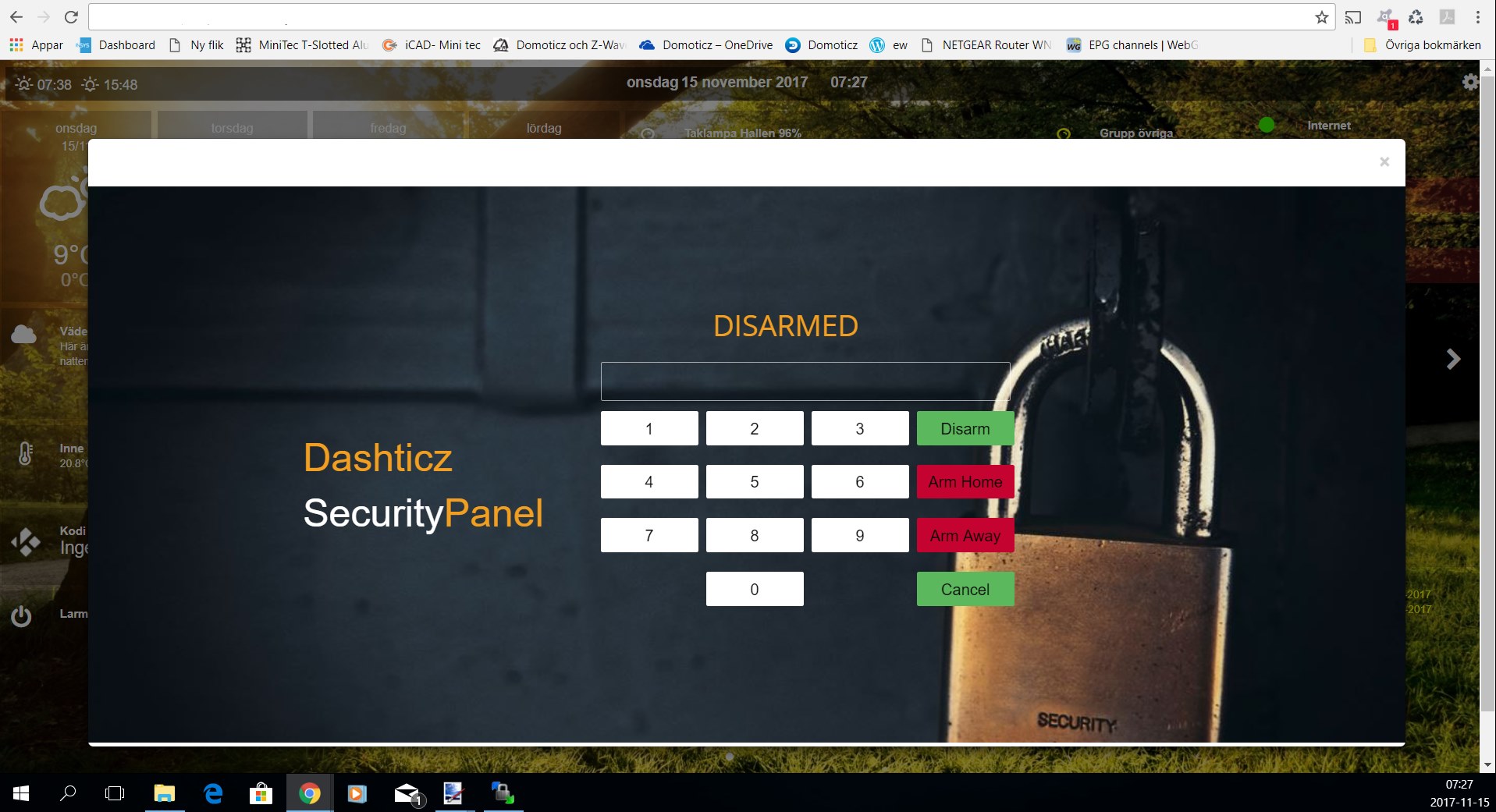

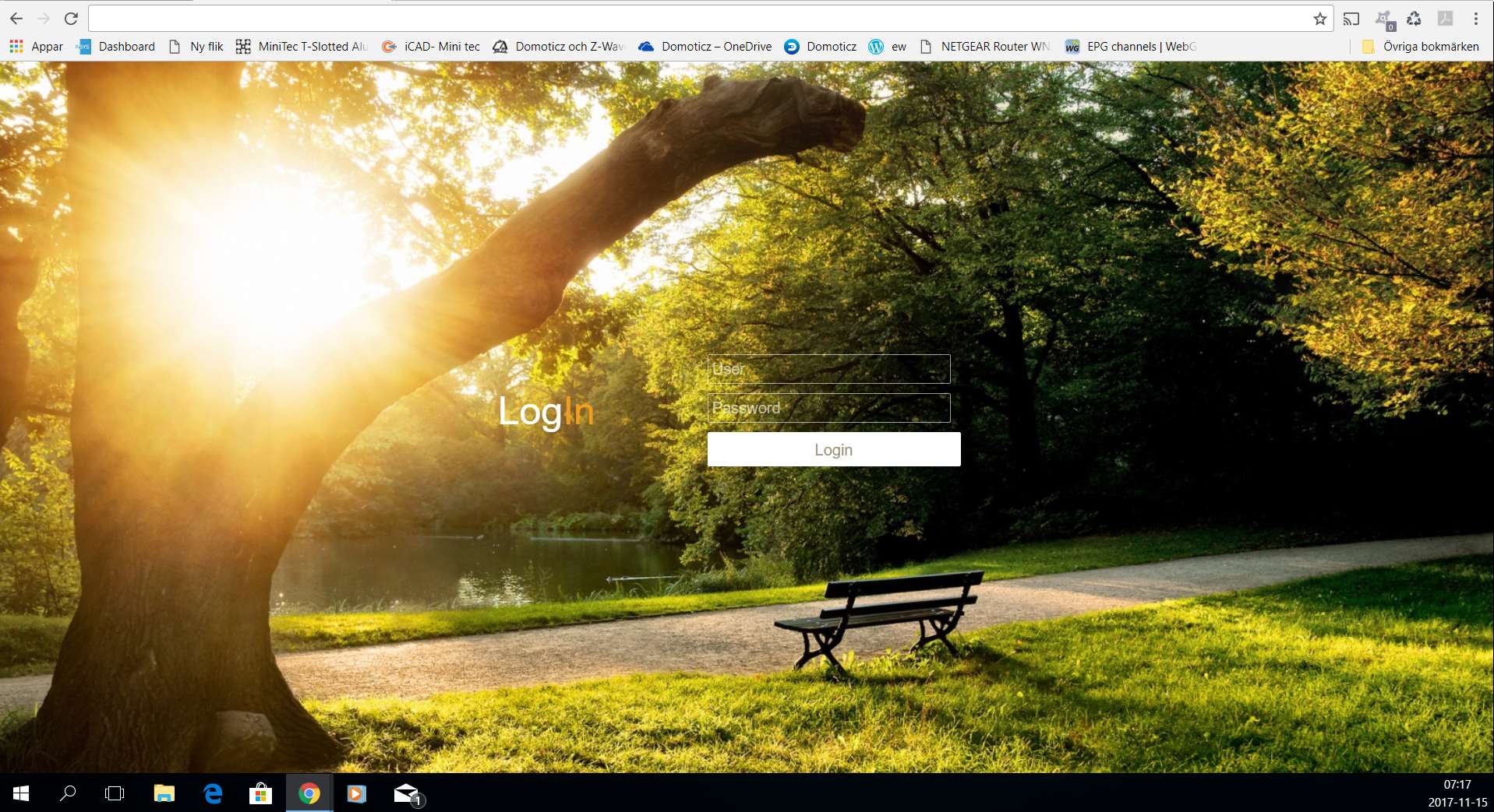

My modded Dashticz dashboard with custom login and secpanel.
I created a separate html page for secpanel. But I suggest that its better the secpanel is integrated to Dashticz.
Also created a html page for login page and I had modify settings.js to make this work.
Custom Login
Dashboard
Custom Secpanel
