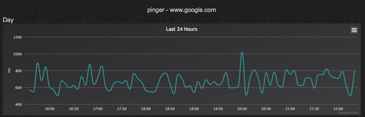

For each "utility" sensor a graph is made by Domoticz, picture below after 6+ hours.
Schermafbeelding 2017-11-29 om 22.25.10.png (118.68 KiB) Viewed 5628 times
Just as I wanted, well done, I'm happy :-)
