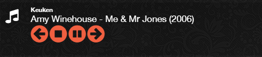

Dashticz supports the Logitech Media Players in Domoticz (which can be the popular picoreplayer which I use myself on a raspberry pi with hifiberry amp)
This enables control of the music player(s):
(this image includes the CSS change as documented on the Dashticz wiki to increase the button sizes)
To use, add a block with your device id (in my case 107 to config.js)
blocks[107] = {}
blocks[107]['width'] = 12;
blocks[107]['icon'] = 'fa-music';
columns[1]['blocks'] = ['107']

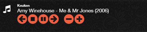

@Rob Geerts,
Can you extend the LMS block with volume control?
I replaced your code with the following to get to this result
else if(device['HardwareType']=='Logitech Media Server'){
									html+=iconORimage(idx,'fa-music','','on icon','',2);
									html+='<div class="col-xs-10 col-data">';
									html+='<strong class="title">'+device['Name']+'</strong><br />';
									html+='<span class="h4">'+device['Data']+'</span>';
									html+='<div>';
										html+='<a href="javascript:controlLogitech('+device['idx']+',\'Rewind\');"><em class="fa fa-arrow-circle-left fa-small"></em></a> ';
										html+='<a href="javascript:controlLogitech('+device['idx']+',\'Stop\');"><em class="fa fa-stop-circle fa-small"></em></a> ';
										if(device['Status']=='Playing') {
												html+='<a href="javascript:controlLogitech('+device['idx']+',\'Pause\');"><em class="fa fa-pause-circle fa-small"></em></a> ';
										else {
											html+='<a href="javascript:controlLogitech('+device['idx']+',\'Play\');"><em class="fa fa-play-circle fa-small"></em></a> ';
										html+='<a href="javascript:controlLogitech('+device['idx']+',\'Forward\');"><em class="fa fa-arrow-circle-right fa-small"></em></a>';
										html+='&nbsp;&nbsp;&nbsp;&nbsp;&nbsp;&nbsp;';
										html+='<a href="javascript:controlLogitech('+device['idx']+',\'VolumeDown\');"><em class="fa fa-minus-circle fa-small"></em></a>';
										html+='&nbsp;';
										html+='<a href="javascript:controlLogitech('+device['idx']+',\'VolumeUp\');"><em class="fa fa-plus-circle fa-small"></em></a>';
									html+='</div>';
									html+='</div>';
									$('div.block_'+idx).addClass('with_controls');
robgeerts
Posts: 1273
Domoticz version: 3.7067
Re: Dashticz - Logitech Media Server
Post by robgeerts »
Fixed in latest beta! Thanks!
