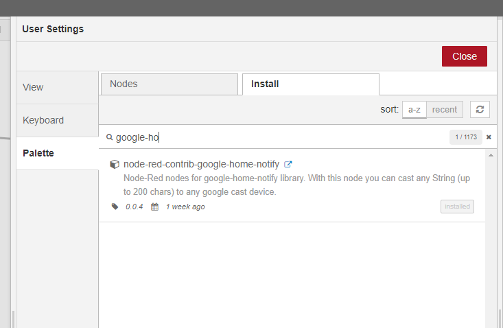

I try to build a virtual device with a text sensor that can be used as an input to node-red using the google-home-notification node. It is too easy to install and use node-red so comparing to other implementations it did not require a middleware to send the tts to google home.
My issue is that I need to build a dzvents script and parse the text of the text sensor via MQTT when value (text) changed.
Any help?

Google Home - Node Red = TTS
- google-home-notify.png (21.55 KiB) Viewed 5806 times
