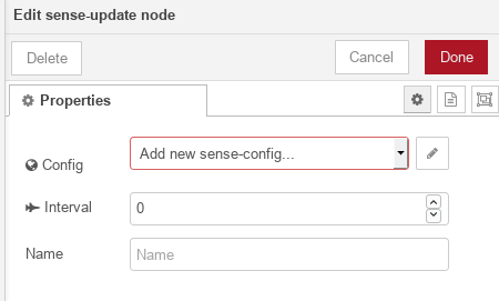

1. Drag and drop the node (under sense), called "sense-update" to the Work Space.
2. Double click on the node and the properties of the node will open.
3. Click on the pencil right of "Add new sense-config".

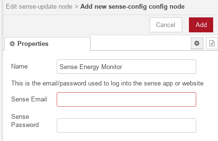

4. The configuration of the node will open. (This is a one time action and the data is stored in a hidden node).
5. Give the config a name, e,g, Sense Water Monitor, what ever you want (Sense Energy Monitor as in the picture is also OK).
6. Fill in your credentials (email and password).
7. Click on "Add". and the "Config" node will close.
8. Interval is optional and you can leave it as default (0) for know.
9. Name of this node is completely up to you, but give it a name that make sense, e.g. Sense Water Monitor.
