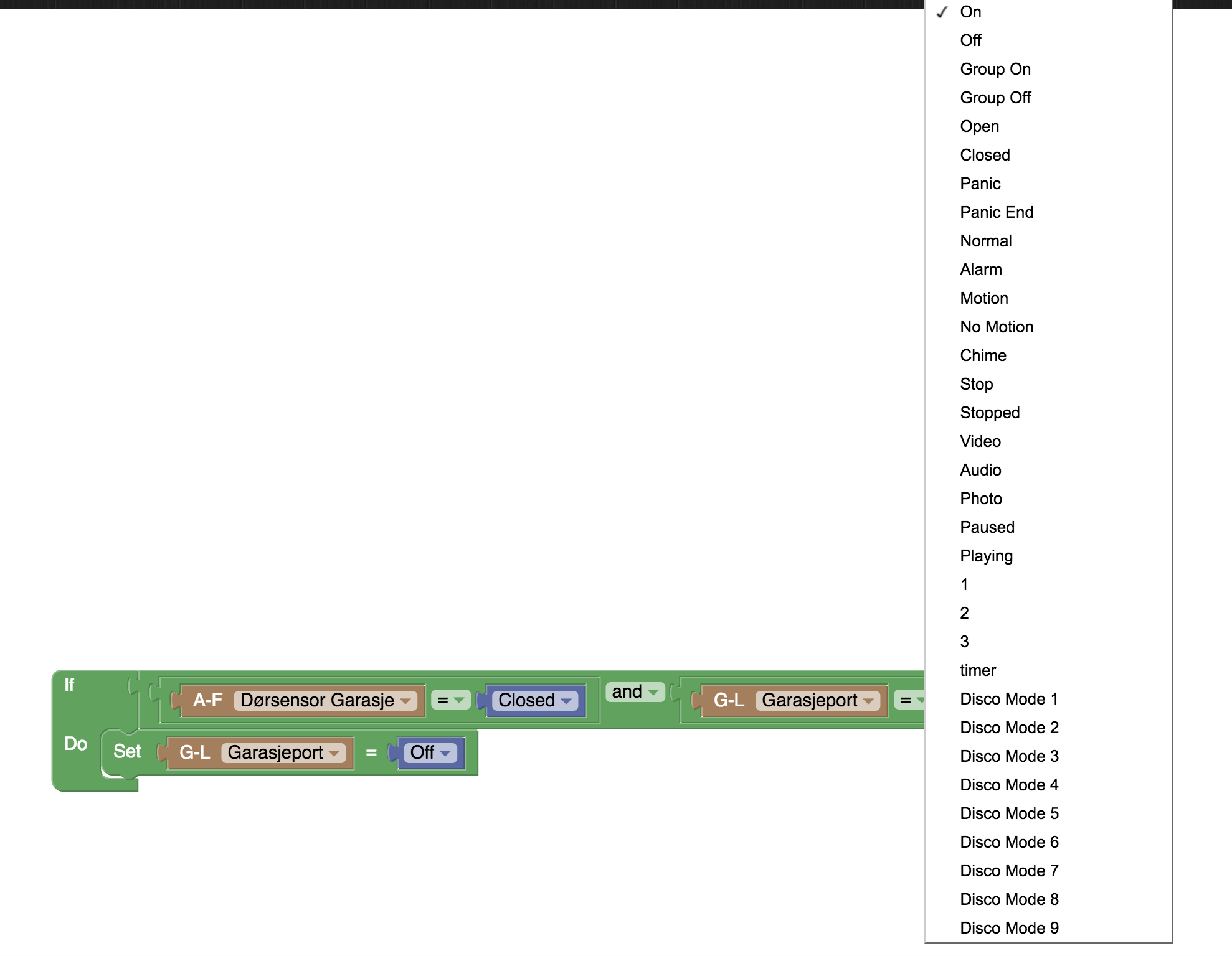

After updating from an old version to the latest Beta I have issues with some of my switches.
Siri stopped responding to "Open" and "Close" commands on "Door Contact" switches so I replaced them with "Door Lock" switches.
After I did that, some of my Blockly based event triggers failed.
"Door Lock" switches have "Locked" and "Unlocked" states but these states are not available as an option in Logic blocks.
You can select On, Off, Open, Closed and so on, but not Locked and Unlocked.
Is this a bug or am I doing something wrong?

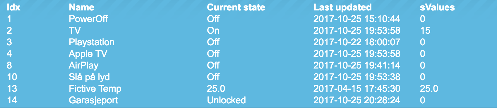

Blockly Switch Status (IDX14-Garasjeport=Unlocked):
Logic Block Options (Unlocked & Locked is missing):
