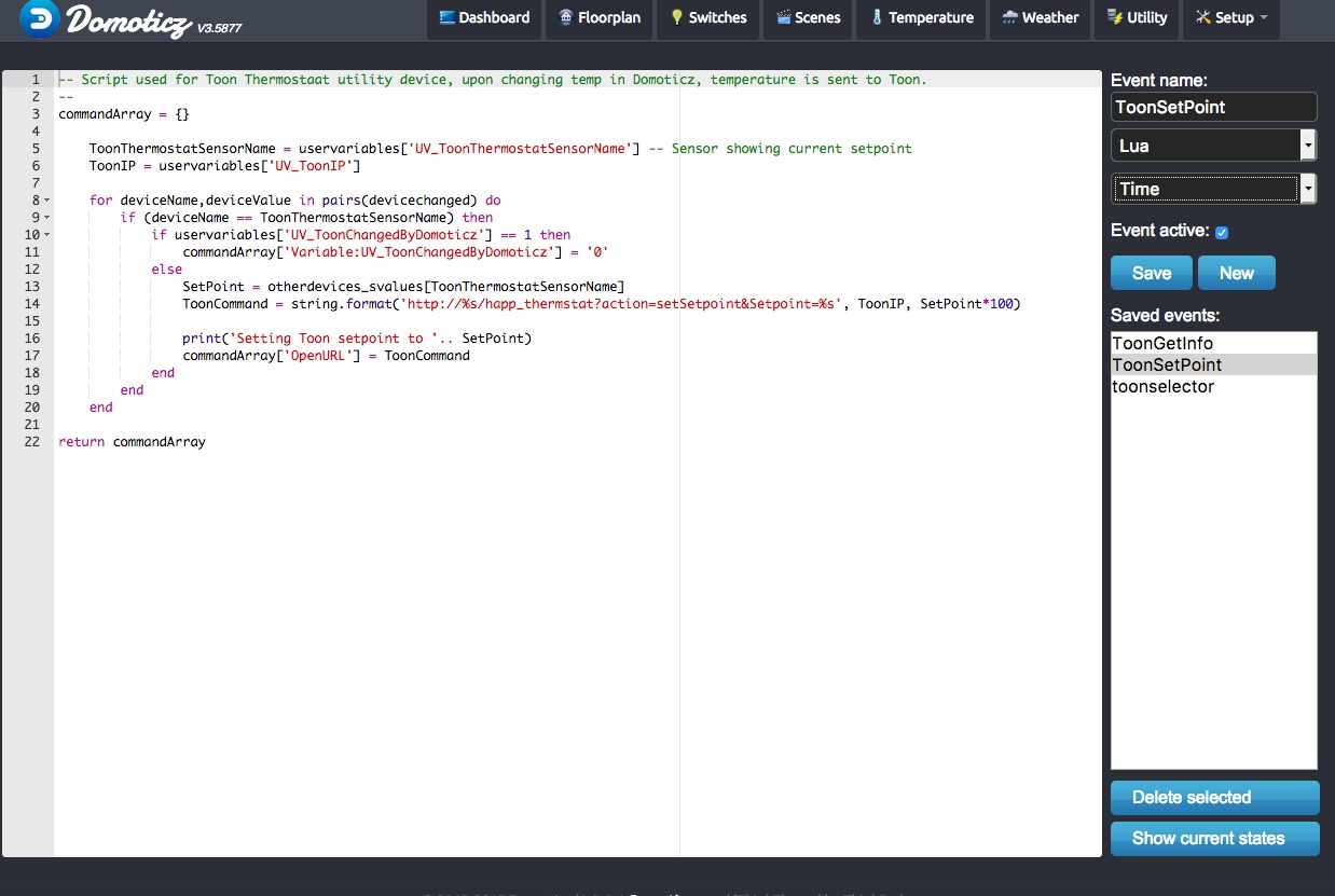

There was an error on my events, was set on Time instead of device. Change that, now it works.
Schermafbeelding 2017-10-09 om 18.59.18.jpg (154.16 KiB) Viewed 5229 times
