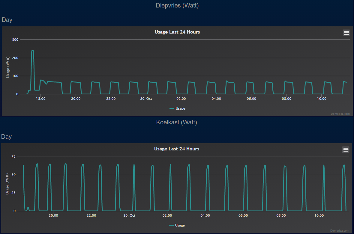

Anyone having the NEO coolcam powerplugs connected to their refrigerator or freezer to monitor energy usage ? Some answers within this thread seem to go for a no-go. And others for a no go at all for the NEO powerplugs. Currently I have several attached to low power using appliances max 500w. The Quooker with 1800w is the max.

Yes I have! Working very well! One remark it’s a a+++ freezer. Max usage 170watt Image
