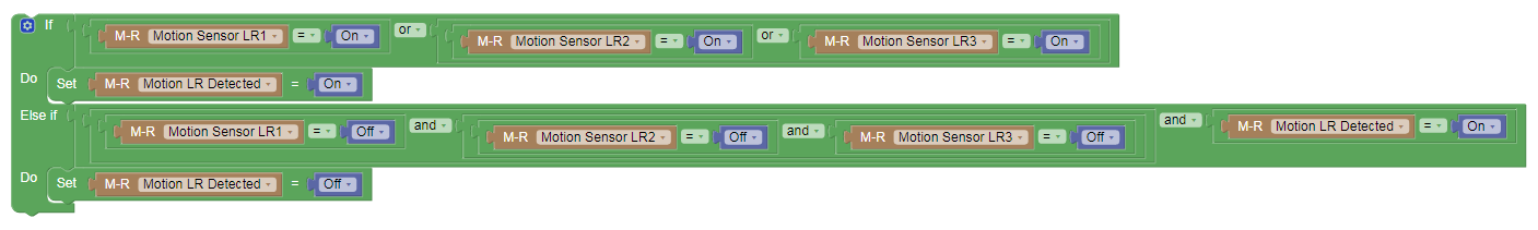

Motion detection:
Motion Detection.PNG (31.91 KiB) Viewed 1026 times

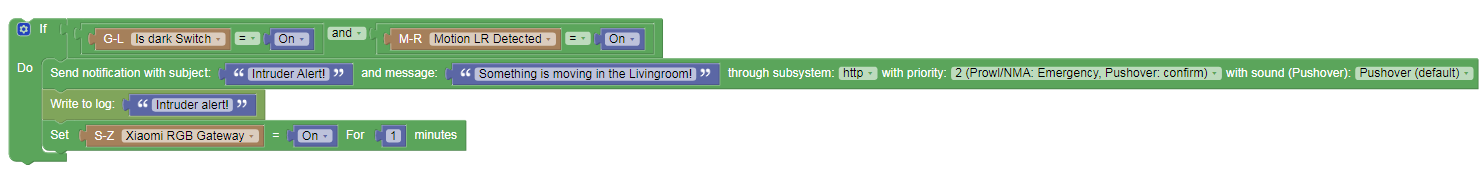

Alarm:
The 'Is Dark Switch' and 'Motion Detected LR' are working fine and trigger on and off at the right times, but alarm isn't triggered.
I've chosen for the 'Device' setting for both blocklys, can't imagine that's not the right setting.

I think the Alarm blockly has the wrong if/do block. It looks like you used the if/then/else if block, but in this case you need the other one without the else/if possibility.

Thanks.....stupid mistake...Shame on me.... ;)
