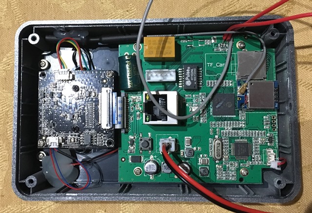

jumble
Joined: Monday 17 July 2017 12:44
Re: IP Video Door Bell - Atz-dbv01p
Post by jumble »
Thanks riogrande75 for figuring out the console. I have a slightly different version of the doorbell but was able to connect to the console as in the following image.
doorbell image.JPG (142.48 KiB) Viewed 10394 times
The console produces the following output on startup.

It would seem if we wright a program/script to parse the console output looking for "push : Some Body visit!" we would have the trigger to send a UDP message. http://www.linux.it/~rubini/docs/sercons/sercons.htm has an example program that may be useful.
I am intending to set up a development environment when I get some spare time and see how we go!
riogrande75
Posts: 21
Joined: Thursday 27 October 2016 7:38
Post by riogrande75 »
Cool. The posted output is pretty identical to my ATZ-DBV03p. So sw seems to be the same.
I managed to write a program to send a simple UDP message already - tested on the doorbell. Works fine.
So far I could not grab the output on the console with a c prog. I tried different functions (fget,fopen,popen,...) on /dev/console and /dev/ttyAMA0 - but somehow it's a bit different to other linux systems I know so far.
Maybe we need to catch the output of the running npc task (this task produces the output). If this still does not work, someone needs to have a look at the gpio's. From the SDK from HiSilicon I got compiled "i2c_read" and "i2c_write" commands, but gpio's are polled somehow different to a RPi.
riogrande75
Posts: 21
Finally i found some time to play again with the doorbell. And I made some progress: I have now a tiny c-program, that sends a udp message including "YOU HAVE A VISITOR WAITING!" to a defined server as soon as the doorbell button was pressed.
All you have to do is getting telnet access to the doorbell (see above: "telnetd" at the console / putty), copy my program (either via tftp or manully on your pc) to the sd-card run it.
Anyone who's interrested just pm me for the code or a specific binary for your environment.
