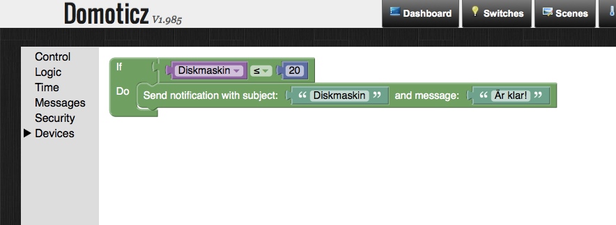

I trying to figuer out how I'm gona get notification when the dishwasher is finish. I thought that you could create a Event like the picture. But I don't receive any notification, maybe the Event function don't work like I thought.
I have tried the Notification at the #Utility but it doesn't seems to work. It works first time, but when I put a load and then turn the load of it won't send any.
Then I want to customize the message, so I hope someone can help me to get this to work with Event instead or maybe a lua script.
Thanks for the help.

It's look like that the value doesn't register some how.. I made a simple Event that when the consumption whent down it turn on my livingroom lights, but even that dosen't work.
IF device < value (watt)
do livingroom = on
What can be wrong here? If i look in the Show Current states I see that the value on my consumption changes..
