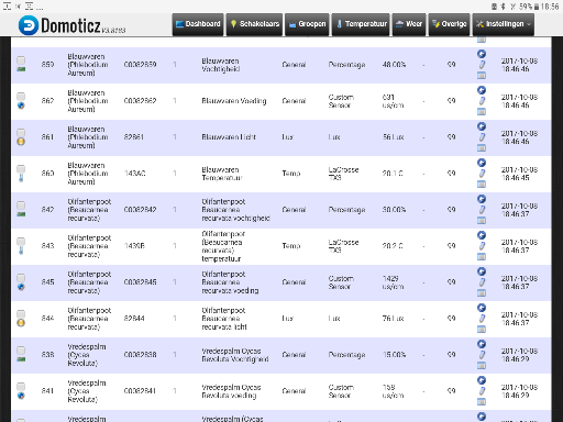

the battery status is shown in the normal domoticz way :D
