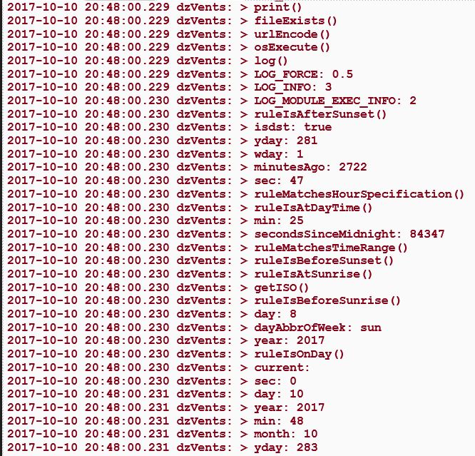

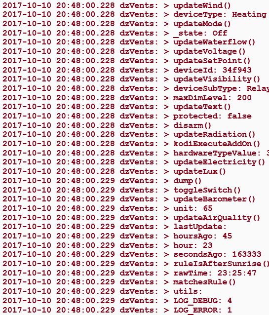

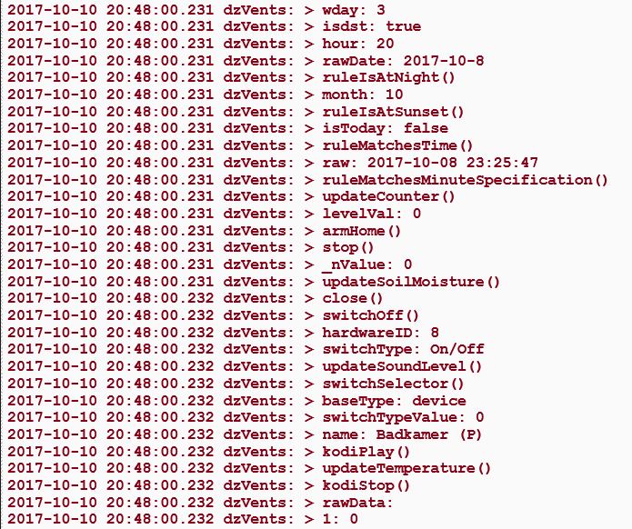

That is not the situation here. The device that you do the switchOn/Off with is not a switch type device. What kind of device is it? (you can do myDevice.dump()). Can you post the results (hardwaretype, devicetype etc) here?
Bertvdw
- Posts: 19
- Joined: Sunday 08 October 2017 23:39
Re: Evohome BDR91?
I added in the hardware tab the device as a Relay in the evohome line as an extra relay to switch on and off the pump of the floorheating.
The result of the mydevice.dump() statement is in the attachments
hardwareid = 8
devicetype = heating
deviceSubType = Relay
switchType = On/Off
Bert
hardwareid = 8
switchType = On/Off
Bert
