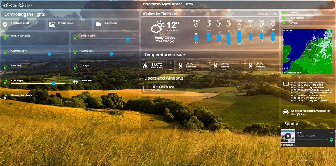

Been busy with my dashboard over the last week. There are still some things that aren't working, like the news block and trafficmap. I have no clue why it doesn't work... so if anyone has a suggestion, please let me know :)
I've added my doorbell device but made it hidden so that you can hear a doorbell sound on the tablet but you can't see anything on the dashboard.
Config
////////////////////// GENERAL CONFIG /////////////////////////
var config = {}
config['domoticz_ip'] = 'XXX';
config['app_title'] = 'Dashboard';
config['default_news_url'] = 'https://crossorigin.me/http://feeds.bbci.co.uk/news/world/europe/rss.xml';
config['news_scroll_after'] = '7';
config['standby_after'] = 0;
config['auto_swipe_back_to'] = 1;
config['auto_swipe_back_after'] = '10';
config['auto_slide_pages'] = 0;
config['slide_effect'] = 'slide';
config['standard_graph'] = 'hours';
config['language'] = 'en_US';
config['timeformat'] = 'DD-MM-YY HH:mm';
config['calendarlanguage'] = 'en_US';
config['calendarurl'] = 0;
config['boss_stationclock'] = 'RedBoss';
config['gm_api'] = 'XXX';
config['gm_zoomlevel'] = '8';
config['gm_latitude'] = 'XXX';
config['gm_longitude'] = 'XXX';
config['wu_api'] = 'XXX';
config['wu_city'] = 'The Hague';
config['wu_name'] = 'in The Hague';
config['wu_country'] = 'NL';
config['idx_moonpicture'] = 0;
config['switch_horizon'] = 0;
config['host_nzbget'] = 0;
config['spot_clientid'] = 'XXX';
config['garbage_company'] = 0;
config['garbage_icalurl'] = 0;
config['garbage_zipcode'] = 0;
config['garbage_street'] = 0;
config['garbage_housenumber'] = 0;
config['garbage_maxitems'] = 0;
config['garbage_width'] = 0;
config['selector_instead_of_buttons'] = 0;
config['auto_positioning'] = 0;
config['use_favorites'] = 0;
config['last_update'] = 1;
config['hide_topbar'] = 0;
config['hide_seconds'] = 1;
config['hide_seconds_stationclock'] = 0;
config['use_fahrenheit'] = 0;
config['use_beaufort'] = 0;
config['translate_windspeed'] = 1;
config['static_weathericons'] = 0;
config['hide_mediaplayer'] = 0;
//var trashnames = {}
//trashnames['Gft'] = 'GFT';
//trashnames['Pmd'] = 'Plastic';
//trashnames['Rest'] = 'Rest'; //LEAVE EMPTY IF YOU WANT TO HIDE IT
var tvguide = {}
tvguide.dutch = { key:'dutch', icon: 'fa-television', width:12, channels: [7,8,464,25,438], maxitems: 8 }
var _STREAMPLAYER_TRACKS  	= [
	{"track":1,"name":"Q-music","file":"http://icecast-qmusic.cdp.triple-it.nl/Qmusic_nl_live_96.mp3"},
	{"track":2,"name":"538 Hitzone","file":"http://vip-icecast.538.lw.triple-it.nl/WEB11_MP3"},
	{"track":3,"name":"Slam! NonStop","file":"http://stream.radiocorp.nl/web10_mp3"},
	{"track":4,"name":"BBC Radio 1","file":"http://radiofeeds.co.uk/bbcradio1.pls"},  ];
////////////////////// FRAMES ///////////////////////////
var frames = {}
frames.weather = {refreshiframe:10000,height:230,frameurl:"//forecast.io/embed/#lat=52.081316&lon=4.383277&name=The Hague&color=#00aaff&font=Helvetica&fontcolor=#ffffff&units=si&text-color=#fff",width:12}
////////////////////// BUTTONS /////////////////////////
var buttons = {}
buttons.buienradar = {width:12, isimage:true, refreshimage:60000, image:'http://api.buienradar.nl/image/1.0/RadarMapNL?w=285&h=256', url:'https://gadgets.buienradar.nl/gadget/zoommap/?lat=52.06022&lng=4.39288&overname=2&zoom=13&naam=2493bj&size=3&voor=1'}
////////////////////// BLOCK TITLES /////////////////////////
var blocks = {}
blocks['blocktitle_tv'] = {}
blocks['blocktitle_tv']['key'] = 'blocktitle_tv';
blocks['blocktitle_tv']['type'] = 'blocktitle';
blocks['blocktitle_tv']['title'] = 'TV and news';
blocks['blocktitle_switches'] = {}
blocks['blocktitle_switches']['key'] = 'blocktitle_switches';
blocks['blocktitle_switches']['type'] = 'blocktitle';
blocks['blocktitle_switches']['title'] = 'Controlling the lights';
blocks['blocktitle_temp'] = {}
blocks['blocktitle_temp']['key'] = 'blocktitle_temp';
blocks['blocktitle_temp']['type'] = 'blocktitle';
blocks['blocktitle_temp']['title'] = 'Temperatures inside';
blocks['blocktitle_doors'] = {}
blocks['blocktitle_doors']['key'] = 'blocktitle_doors';
blocks['blocktitle_doors']['type'] = 'blocktitle';
blocks['blocktitle_doors']['title'] = 'Doors and windows';
blocks['blocktitle_spotify'] = {}
blocks['blocktitle_spotify']['key'] = 'blocktitle_spotify';
blocks['blocktitle_spotify']['type'] = 'blocktitle';
blocks['blocktitle_spotify']['title'] = 'Spotify';
// custom block width for switches
blocks['news_2'] = {}
blocks['news_2']['feed'] = 'http://feeds.bbci.co.uk/news/world/europe/rss.xml';
blocks[104] = {} //
blocks[104]['width'] = 4;
blocks[104]['title'] = 'The front door is now:'
blocks['s1'] = {} //Scene Front room all off
blocks['s1']['hide_data'] = true;
blocks['s1']['hide_lastupdate'] = true;
blocks['s1']['icon'] = 'fa-times-circle';
blocks['s2'] = {} //Movie scene
blocks['s2']['hide_data'] = true;
blocks['s2']['hide_lastupdate'] = true;
blocks['s2']['icon'] = 'fa-video-camera';
blocks['s3'] = {} //Evening scene
blocks['s3']['hide_data'] = true;
blocks['s3']['hide_lastupdate'] = true;
blocks['s3']['icon'] = 'fa-image';
blocks[73] = {} //kitchen light string
blocks[73]['width'] = 6;
blocks[73]['title'] = 'Kitchen light string'
blocks[73]['hide_data'] = true;
blocks[73]['hide_lastupdate'] = true;
blocks[93] = {} //kitchen spots dimmer
blocks[93]['width'] = 6;
blocks[93]['title'] = 'Kitchen spots'
blocks[93]['hide_data'] = true;
blocks[93]['hide_lastupdate'] = true;
blocks[74] = {}
blocks[74]['width'] = 6;
blocks[74]['title'] = 'Cupboard spots'
blocks[74]['hide_data'] = true;
blocks[74]['hide_lastupdate'] = true;
blocks[72] = {}
blocks[72]['width'] = 6;
blocks[72]['title'] = 'Ceiling light'
blocks[72]['hide_data'] = true;
blocks[72]['hide_lastupdate'] = true;
blocks[44] = {}
blocks[44]['width'] = 6;
blocks[44]['title'] = 'Floor lamp'
blocks[44]['hide_data'] = true;
blocks[44]['hide_lastupdate'] = true;
blocks[18] = {}
blocks[18]['width'] = 6;
blocks[18]['title'] = 'TV light'
blocks[18]['hide_data'] = true;
blocks[18]['hide_lastupdate'] = true;
blocks[70] = {}
blocks[70]['width'] = 6;
blocks[70]['title'] = 'Couch light'
blocks[70]['hide_data'] = true;
blocks[70]['hide_lastupdate'] = true;
blocks[17] = {}
blocks[17]['width'] = 6;
blocks[17]['title'] = 'Subwoofer'
blocks[17]['hide_data'] = true;
blocks[17]['hide_lastupdate'] = true;
blocks[17]['icon'] = 'fa-volume-up';
blocks[92] = {}
blocks[92]['width'] = 6;
blocks[92]['title'] = 'Bedroom fairy lights'
blocks[92]['hide_data'] = true;
blocks[92]['hide_lastupdate'] = true;
// DOORBELL
blocks[89] = {}
blocks[89]['width'] = 1;
blocks[89]['title'] = ''
blocks[89]['hide_data'] = true;
blocks[89]['hide_lastupdate'] = true;
blocks[89]['playsound'] = 'sounds/doorbell.mp3';
blocks[89]['protected'] = true;
blocks[89]['icon'] = 'fa-bell-o';
//change temp blocks size
blocks[82] = {}
blocks[82]['width'] = 3;
blocks[52] = {}
blocks[52]['width'] = 3;
blocks[54] = {}
blocks[54]['width'] = 3;
blocks[81] = {}
blocks[81]['width'] = 3;
blocks[81]['title'] = 'Change temp.'

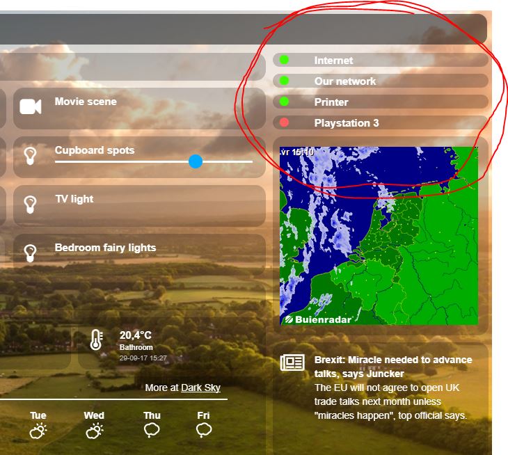

//Device status - ping results
blocks[122] = {}
blocks[122]['width'] = 12;
blocks[122]['title'] = 'Internet'
blocks[122]['hide_data'] = true;
blocks[122]['hide_lastupdate'] = true;
blocks[122]['icon'] = 'fa-circle';
blocks[122]['protected'] = true;
blocks[118] = {}
blocks[118]['width'] = 12;
blocks[118]['title'] = 'Our network'
blocks[118]['hide_data'] = true;
blocks[118]['hide_lastupdate'] = true;
blocks[118]['icon'] = 'fa-circle';
blocks[118]['protected'] = true;
blocks[121] = {}
blocks[121]['width'] = 12;
blocks[121]['title'] = 'Printer'
blocks[121]['hide_data'] = true;
blocks[121]['hide_lastupdate'] = true;
blocks[121]['icon'] = 'fa-circle';
blocks[121]['protected'] = true;
//blocks['sunrise'] = {}
//blocks['sunrise']['width'] = 1;
//blocks['miniclock'] = {}
//blocks['miniclock']['width'] = 7;
// My IDX list
// 73 = kitchen light string
// 93 = Kitchen spots
// 74 = Cupboard spots
// 72 = Ceiling light
// 44 = Floor lamp
// 18 = TV light
// 70 = Couch light
// 17 = Subwoofer
// 92 = Bedroom fairy lights
////////////////////// COLUMNS /////////////////////////
var columns = {}
columns['bar'] = {}
columns['bar']['blocks'] = ['sunrise','miniclock',89]
columns[1] = {}
columns[1]['blocks'] = ['blocktitle_switches','s1','s3','s2',73,93,74,72,44,18,70,17,92]
columns[1]['width'] = 5;

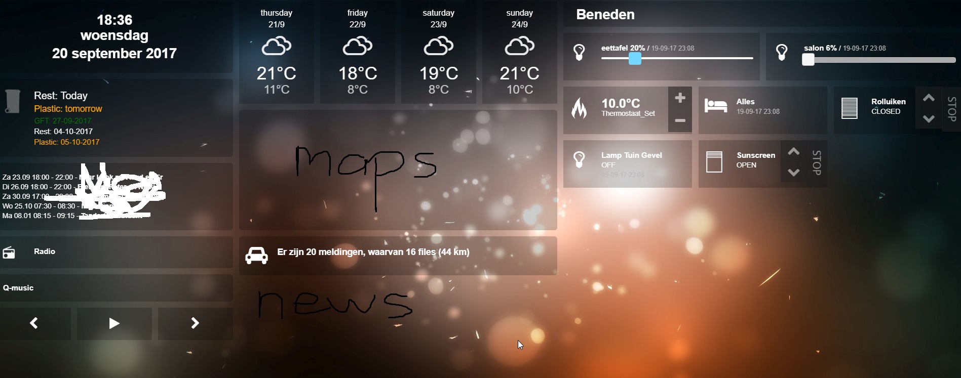

Posts: 499
A little help to make my dashboard awesome
Post by remb0 »
I have a few (i hope small) questions:
1: google maps is not showing a map anymore.
2: Color bulbs on my hue not showing on screen. (known issue with rgbw?)
3: news is not showing (I use nu.nl as default and tweakers as second)
used with crossorigin and without.
with F12 i see:
XMLHttpRequest cannot load https://crossorigin.me/http://www.nu.nl/rss/Algemeen. No 'Access-Control-Allow-Origin' header is present on the requested resource. Origin 'http://192.168.0.8:8080' is therefore not allowed access. The response had HTTP status code 503.
4:
a iframe is not nice looking.
when using this code it's nice but My popup of cammeras are ugly. who has the right code to let the popups intact and the iframe nicer?

wow great dashboard, do you have the imagefiles?
Ingmar
Posts: 51
Joined: Sunday 04 May 2014 1:34
Post by Ingmar »
h143 wrote: Monday 25 September 2017 21:09
Ingmar wrote: Tuesday 19 September 2017 10:03 Been busy with my dashboard over the last week. There are still some things that aren't working, like the news block and trafficmap. I have no clue why it doesn't work... so if anyone has a suggestion, please let me know :)
Of which images? The background?
Synology NAS with stable release, AEON Z-wave, RFXCOM, Toon, Echo Dot, HAbridge, HarmonyHUB, Dashticz.

remb0 wrote: Wednesday 20 September 2017 19:07 6: my link to nas is not showing.?
my config:
var config = {}
blocks['nas'] = {} // Ping Esx
blocks['nas']['width'] = 3;
blocks['nas']['icon'] = 'fa-server';
blocks['nas']['title'] = 'NAS';
blocks['nas']['link'] = 'http://192.168.0.99';
blocks['nas']['target'] = 'iframe'; // iframe, tab, window
I don't have a solution, but an alternative way. This is how I'm using it for pinging my printer:
I've made a virtual switch in domoticz called Printer_status. Then in domoticz Setup > Events, I created a new Lua/Time event with the following code:
--Ping printer
 ping_success=os.execute('ping -c1 192.168.1.1')
 if ping_success then
   print("ping success")
   commandArray['Printer_status']='On'
   print("ping fail")
   commandArray['Printer_status']='Off'
return commandArray
Then in the dashboard it's a block like any other light switch. Then pick an icon from Font Awesome and you can do anything you like with it. I made this of it:
