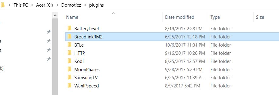

first check if your pyhon system is running
you need to have this folder structure

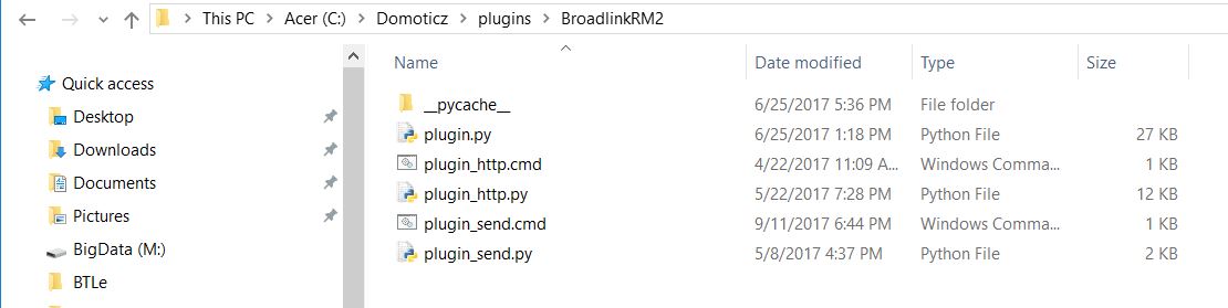

and these files inside
