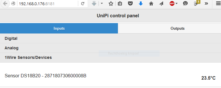

The good news:
- Domoticz is running fine! More hardware is on my wish list...
- ImperiHome is running
- UniPi installed and controllable via webinterface

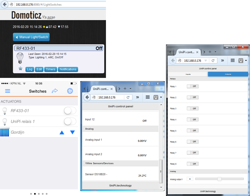

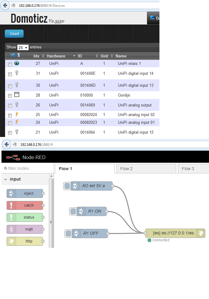

The challenge however: how can Domoticz and UniPi work together!? I created all the virtual sensors and switches in Domoticz. I installed Node-RED and can switch the relais by clicking on the nodes in the flow.
192.168.0.176-1880 and 8080.PNG (76.54 KiB) Viewed 7051 times
In the script folder
pi@raspberrypi ~/domoticz/scripts/lua $ ls
5.2       script_UniPi_domoticz.lua  script_time_demo.lua
JSON.lua  script_device_demo.lua
JSON and the above UniPi script are placed. The latter has been edited by the virtual switches (idxr numbers).
What step am I missing!? Do I have to run the scripts or does this automatically start on reboot? Domoticz cannot control the relays nor recognises the sensors.

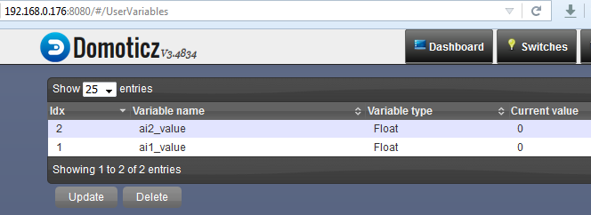

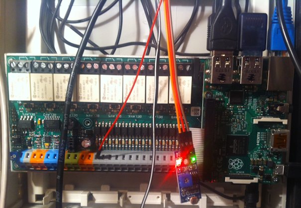

I also have some difficulties with the digital input. I have some el cheapo sensors https://www.hobbyelectronica.nl/product ... ensor-ldr/ in an effort to read my analogue power meter. They run on 5V. The blinking of the LED triggers the sensor (after changing the sensitivity right). The sensor triggers the UniPi because I see the LED on the UniPi board blinking at the same time. However Domoticz doesn't see the utility device nor the pulses. Did you make some progress?
The log file is nagging many times a minute:
 2016-09-02 19:57:06.310 Error: EventSystem: commandArray in script /home/pi/domoticz/scripts/lua/script_device_UniPi.lua should only return ['string']='actionstring' or [integer]={['string']='actionstring'}
2016-09-02 19:57:11.473 Error: EventSystem: commandArray in script /home/pi/domoticz/scripts/lua/script_device_UniPi.lua should only return ['string']='actionstring' or [integer]={['string']='actionstring'}
2016-09-02 19:57:26.891 Error: EventSystem: commandArray in script /home/pi/domoticz/scripts/lua/script_device_UniPi.lua should only return ['string']='actionstring' or [integer]={['string']='actionstring'}
2016-09-02 19:57:26.966 Error: EventSystem: commandArray in script /home/pi/domoticz/scripts/lua/script_device_UniPi.lua should only return ['string']='actionstring' or [integer]={['string']='actionstring'}
2016-09-02 19:57:37.755 Error: EventSystem: commandArray in script /home/pi/domoticz/scripts/lua/script_device_UniPi.lua should only return ['string']='actionstring' or [integer]={['string']='actionstring'}
2016-09-02 19:57:38.735 Error: EventSystem: commandArray in script /home/pi/domoticz/scripts/lua/script_device_UniPi.lua should only return ['string']='actionstring' or [integer]={['string']='actionstring'}
2016-09-02 19:57:42.472 Error: EventSystem: commandArray in script /home/pi/domoticz/scripts/lua/script_device_UniPi.lua should only return ['string']='actionstring' or [integer]={['string']='actionstring'}
2016-09-02 19:57:43.275 Error: EventSystem: commandArray in script /home/pi/domoticz/scripts/lua/script_device_UniPi.lua should only return ['string']='actionstring' or [integer]={['string']='actionstring'}
2016-09-02 19:57:57.093 Error: EventSystem: commandArray in script /home/pi/domoticz/scripts/lua/script_device_UniPi.lua should only return ['string']='actionstring' or [integer]={['string']='actionstring'}
2016-09-02 19:57:57.163 Error: EventSystem: commandArray in script /home/pi/domoticz/scripts/lua/script_device_UniPi.lua should only return ['string']='actionstring' or [integer]={['string']='actionstring'}
Has it something to do with the user variables?
User variables.PNG (23.24 KiB) Viewed 6314 times
