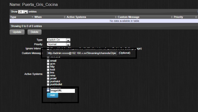

Hello, would it be possible to add a specific section for notifications with Telegram adding the Amazon bucket to send images?
- DomoticzTelegram.jpg (112.33 KiB) Viewed 878 times

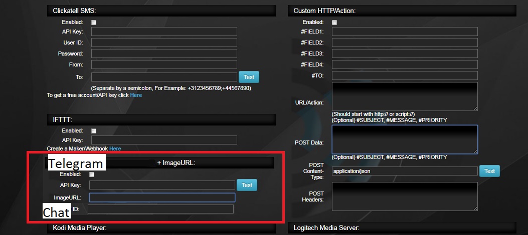

Today I run the following script when an event occurs
#!/bin/sh
curl http://admin:[email protected]/Streami ... /2/picture > /tmp/foto_timbre.jpg
curl -s -X POST "https://api.telegram.org/bot4296sdfasla ... /sendPhoto" -F chat_id=$1 -F photo="@/tmp/foto_timbre.jpg"
In imageURL I would write : http://admin:[email protected]/Streami ... /2/picture
But the ideal would be to be able to define it in ...
Thank you so so so much
Sorry for my writing, I'm using the google translator

- Domoticz_Telegram.jpg (84.72 KiB) Viewed 675 times
