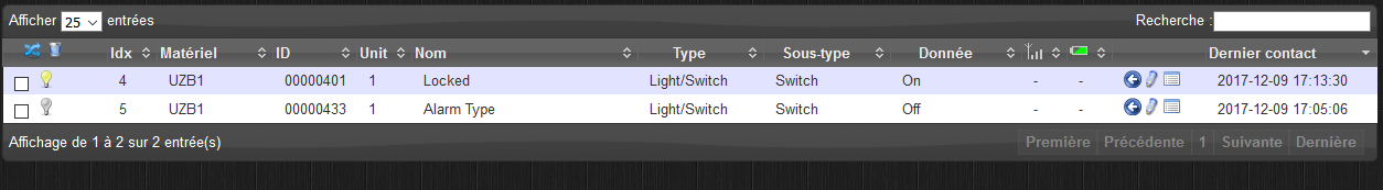

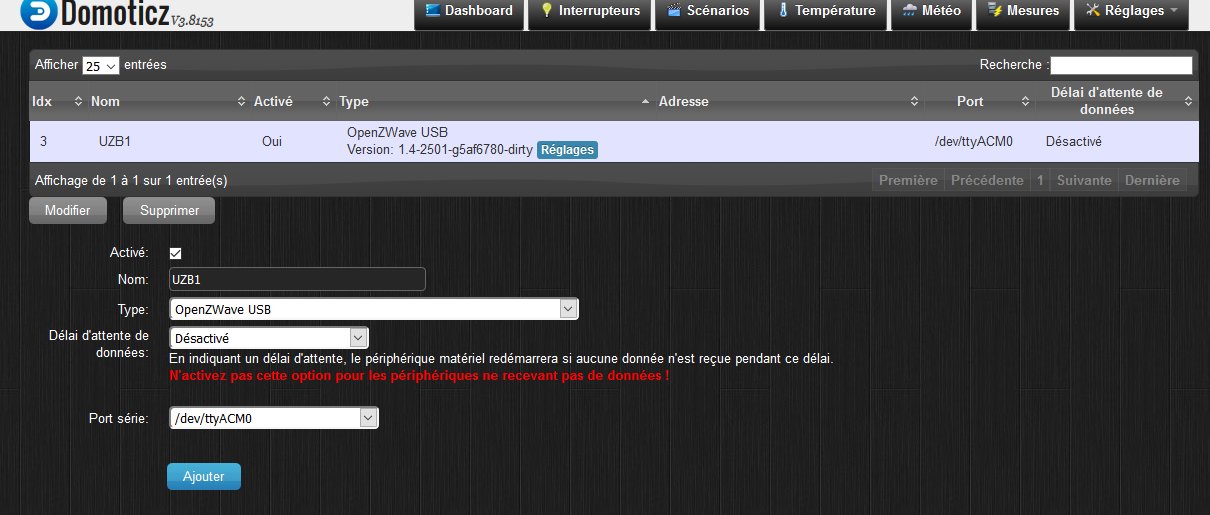

Hello, I am a newbee in domoticz on raspberry and I just bought a Danalock V3, a PI 3B, and an UZB1 usb key for Z-Wave.
Thanks to your help, I have updated my lock and my Pi is running well with ssl and domoticz realease Version 3.8153 (July 30h 2017) et Z-Wave 1.4.2501g5af6780 wich according to my reads should take into account my lock.
Despite of clear tutos , I am not able to pilot my lock from Domoticz ; I can see it as a device but nothing happen whzen i clic on it. Is it a question of release all simply ? if yes how can I find the good one and how should I install it within domoticz
Thanks for your help.
Polo
Polo

I forgot : do you think problem could come from the USB key : UZB1 ?
Polo
Polo
