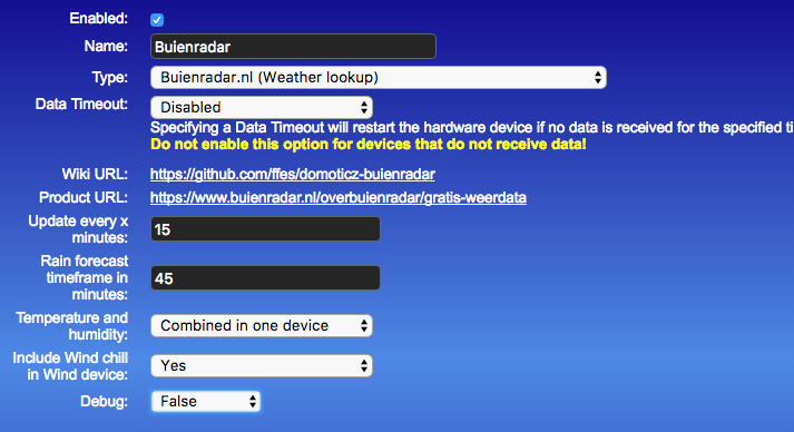

I went back into the Hardware tab and checked the settings on the plugin. Seems that some more items need to be filled in.
Also I had some old values from the previous version in there that did not make sense. Correcting these settings makes it work without the "br" error for me.

@raymond
This are my settings on the hardware tab

I have exactly the same and after a restart of Domoticz it works fine.

raymond wrote: Wednesday 13 September 2017 12:15 I have exactly the same and after a restart of Domoticz it works fine.
Thanks. Now it works

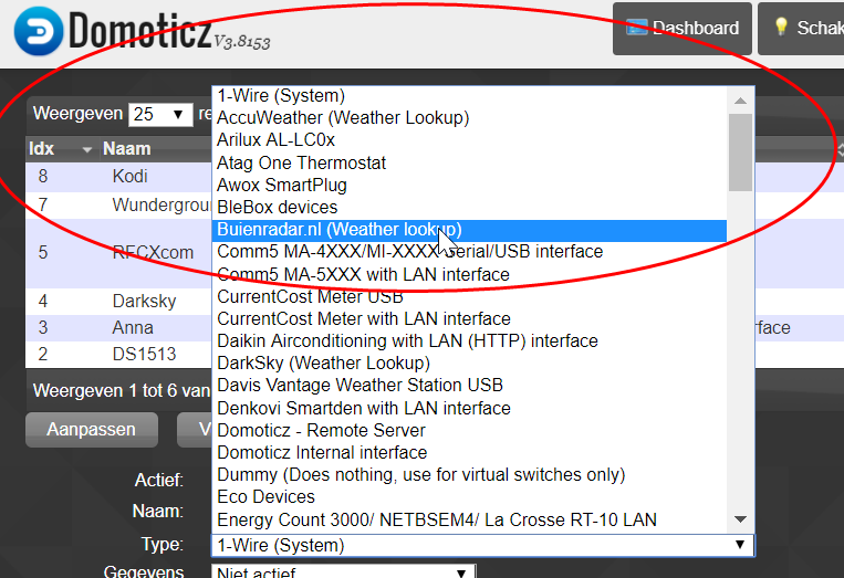

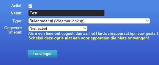

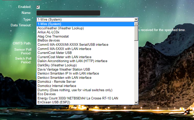

Dear experts,
Can you please help me, I'm running circules.
When I select the plugin in the hardware-tab, I doesn't show any options and I'm not able to add it to the hardware list, the "toevoegen" button doesn't work. See also the picture.
I followed the github for this plugin and managed to get output running python3 localtest.py, from cli in the directory of the plugin.
After several reboots of the Pi (and Domoticz), searched the internet relating to the following log:
2017-10-07 16:51:52.642 PluginSystem: Started, Python version '3.4.2'.
2017-10-07 16:52:07.324 Python EventSystem: Module not found - Trying to initialize.
2017-10-07 16:52:07.330 Python EventSystem: Initalizing event module.
Found in a thread that this seems to be normal, but can somebody please confirm?
I'm running Rpi with Jessie, and Domoticz Version: 3.8153 Build Hash: 494fff7.
Did all apt updates today aswell.
Thanks in advance, John
Found the issue, tried to add plugin with browser: Microsoft Edge/Firefox (latest).
Tried it with an older Chrome ans with Safari on Iphone which was the solution........
