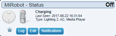

Plugin for Xiaomi Vacuum (based on python-miio)
Can be found here: https://github.com/mrin/domoticz-mirobot-plugin
Provide sub devices:
- Status (polls by interval)
- Control
- Fan Level
- Battery
- Care Main Brush, Side Brush, Filter, Sensor
- Care reset control
