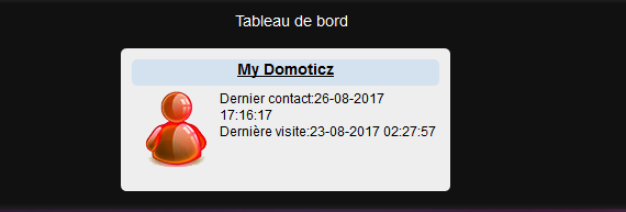

Hi ,
The title should be changed to my.domoticz
I was able to setup the configuration in domoticz and in the my.domoticz portal (registration)
But since 3 days , impossible to connect to the portal , as per the domoticz log and screenshot

What does your Domoticz log file say?
gerardosamara wrote: Saturday 26 August 2017 17:57 Hi ,

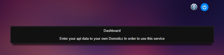

Hi Guys, please how to erase instance from domoticz. My. domoticz Icon is gone, but in domoticz settings still old instance No.
- 1.jpg (20.03 KiB) Viewed 3428 times
